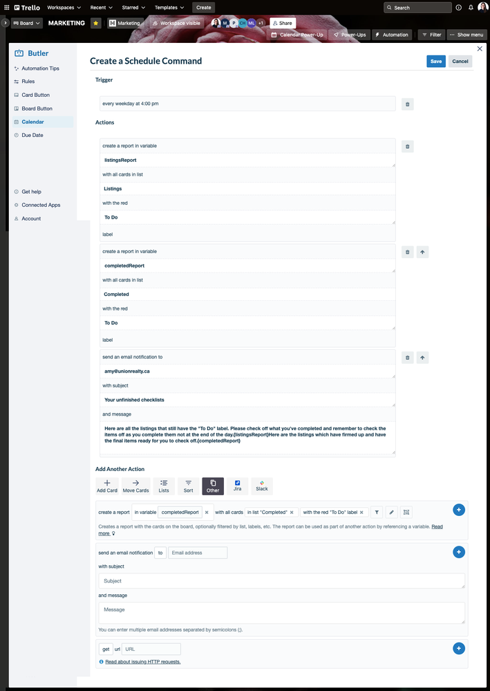

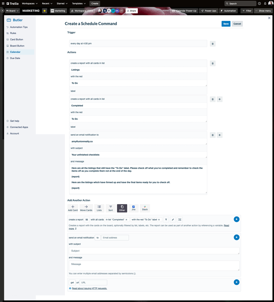

I have an automated email report set up to send at 4pm everyday with items with a certain label in a single list. This works perfectly, I would like the report to start including items from a second list with the same labels. I've tried so many different ways and none of them work. If someone could explain how the report code works? Where do I find the report code? I included where I want the reports to show in the email but if I want multiple reports in an email how do I put the code in?

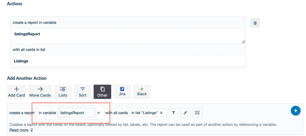

To use multiple report actions, you'll need to specify the "in variable" option on the report action. Otherwise the "report" variable will just be overwritten by the last action.
You'll then reference {listingsReport} and {completedReport} for example, instead of {report}

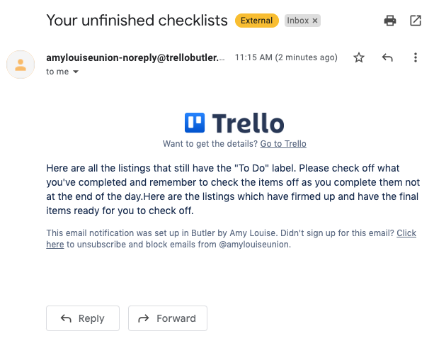

I tried it like that just now and it's still not working. I get the email with no reports.
