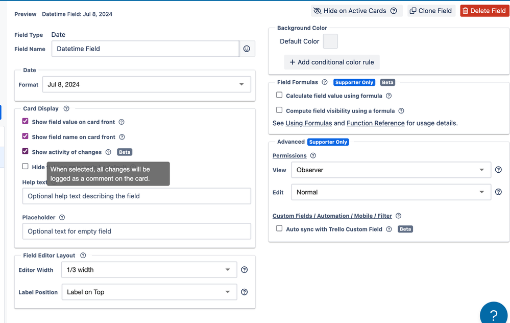

Also, depending on how you're using due dates, you could also use the Amazing Fields Power-Up to create a due date field, and then use the setting to "log activity updates" of that field, which will post comments every time that field is changed showing what it was before and what it was changed to.

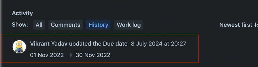

Vikrant Yadav
July 8, 2024
Hi @Dussart  Welcome to Atlassian Community!
Yes, you can get previous due date value using changelog smartvalue :
Previous Date : {{#changelog.duedate}}{{from}}{{/}}

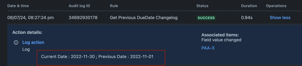

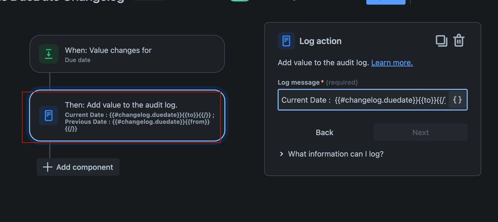

Vikrant Yadav
July 8, 2024
@Dussart  Not sure why it's not working for you. If you share the flow screenshot,I can help you out. I tested on my instance, it's working fine.
Screenshot 2024-07-08 at 8.29.54 PM.pngScreenshot 2024-07-08 at 8.30.35 PM.pngScreenshot 2024-07-08 at 8.31.05 PM.png

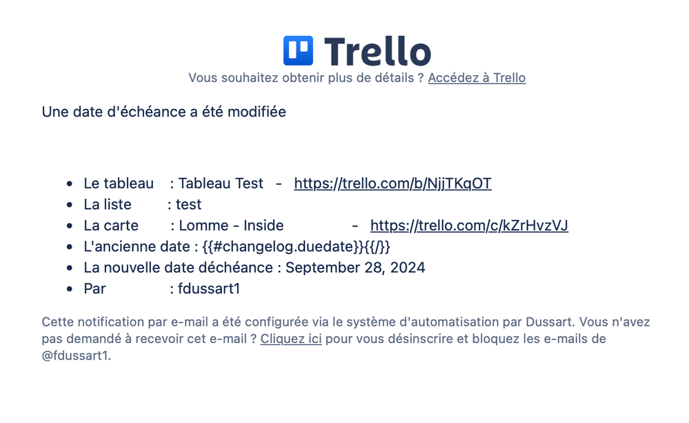

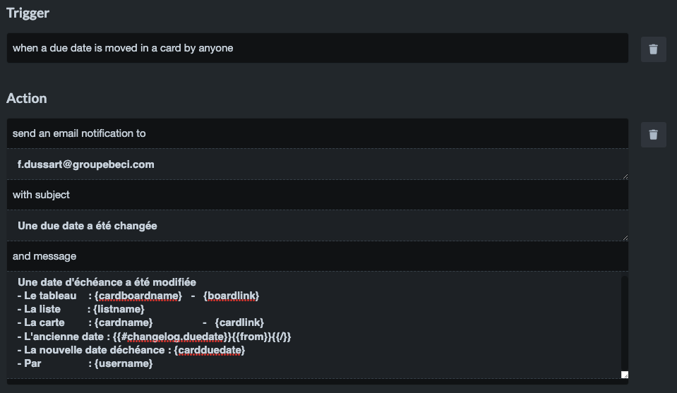

Dussart
July 8, 2024
Here are my automation and the mail i receivedCapture d’écran 2024-07-08 à 17.11.20.pngCapture d’écran 2024-07-08 à 17.12.40.png
