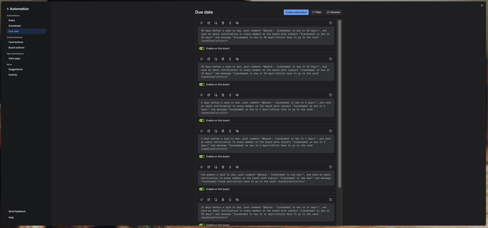

I have the following automations on my Trello boards, but none of them work. Can anybody see what i'm doing wrong? I don't understand it, but none of the actions succeed (ie the comment is not posted to the card, and the email notification is not sent to the board users).

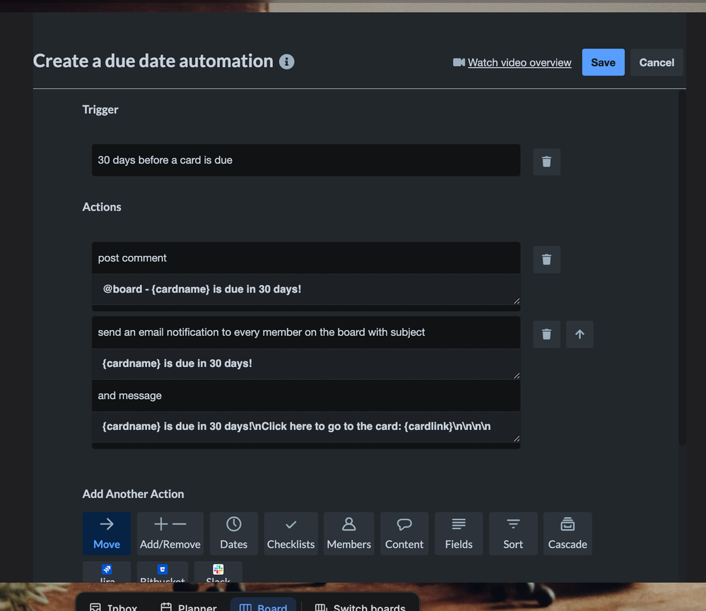

Here is an example of one in the creation wizard:

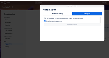

Check Board-> Automation-> Activity, and look for errors  there:

Hello @James Avery
Actually screenshot will be more helpful.
James Avery
April 11, 2026
Hi @Arkadiusz Wroblewski I have just updated the post for you! Thanks :)
Like Arkadiusz Wroblewski likes this
April 11, 2026
@James Avery

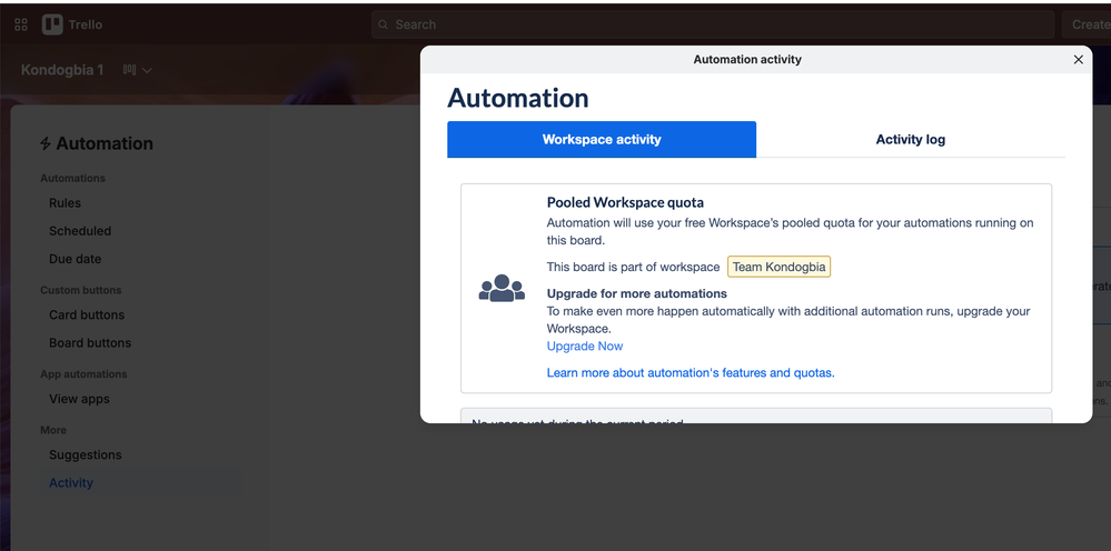

Format is OK, the real problem is much more likely Free-plan limits or due-date timing/timezone.
FREE
