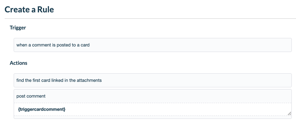

The rules that you're using at the moment seem ok, but you might want to add something like this:
Which will mean that any comment added to the duplicated card will replicate in the MASTER BOARD - now there might be a problem with this - I have no idea if you have this set up on both sides (the master board and the secondary board) whether this will create an infinite loop. So if you want to add comments to the card, you would be better off doing it in the copied card.

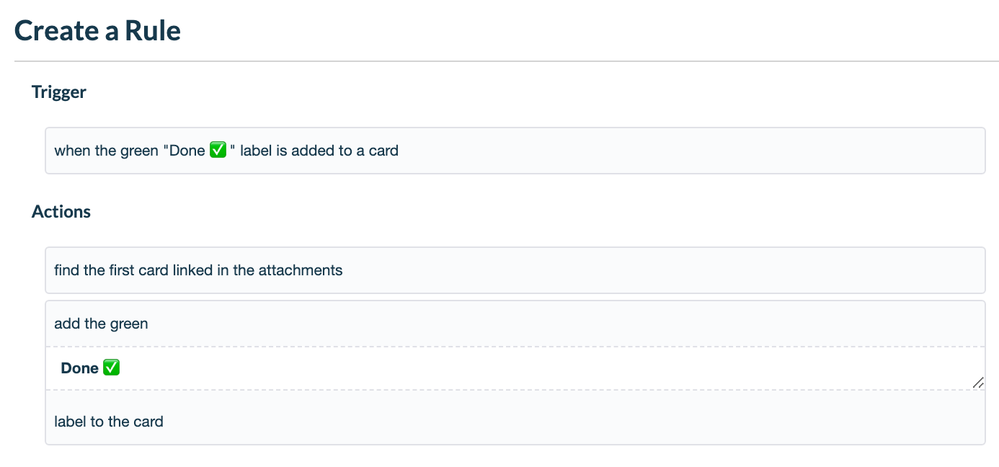

If you want to replicate labels, the rule is pretty similar, however, you're going to have to create this rule for all labels:
Custom Fields are a little bit more tricky though! You might be able to use {triggercardcustomfield} but I'm not 100% sure on that one because I've never used it! Might be worth having a play around with though?

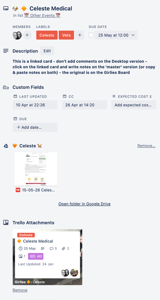

Personally, I've got around it using quite a simple process:
I copy the card to where I want it and link the 2 cards together
Then in the description field I have this (please excuse the fact that this card is for one of my dogs!):
It's really basic, but it means that I can see in the description in bold - that I shouldn't be adding things to this card, and letting me know that the original card is attached, and should that attachment disappear - the board that the card came from!
It's a bit of a pain to do every time, but once it's done it's a copy & paste job!
I don't know if that smoothes some of the problem, but I just thought I'd let you know what I do personally!
Esme :)
That's pretty much what I was referring to by my loose 'double-clicking' through each card.
Not ideal but not too clunky.
However, have tried it with a few live tasks and the process does seem quite jarring and takes away some of the fluidity. Unsure Butler has a better way.

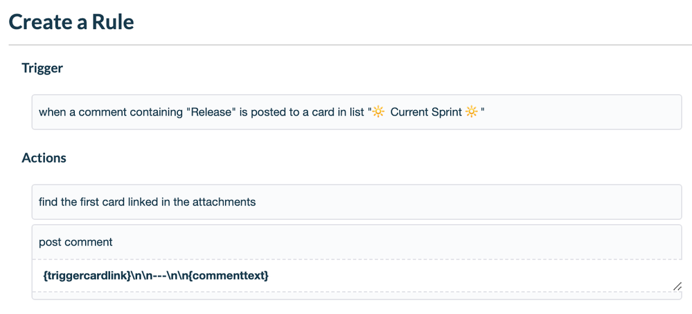

I've actually just created a rule that I thought I might share with you:
I record my workouts on Trello, they all include the Release (because I subscribe to LMOD and they all have a release number or name), and they're all in a specific list, so I can be really specific about the comments that I want to copy over to the main (parent) card. Because I sometimes add comments in the individual cards (because I have a card per day), I don't want it to copy over all the comments, just the workouts, this rule works like a charm! I actually did a bit of a happy dance when I got it working!
So basically, this rule works on one board, but it would easily work across 2 boards (or however many you have) because it's just finding the first card linked in the attachment.
Thought I'd share it, just in case it was useful :)
Thanks for the share Esme. Have just a play with rules based around comments and I feel this is another thing that will need ongoing maintenance.
