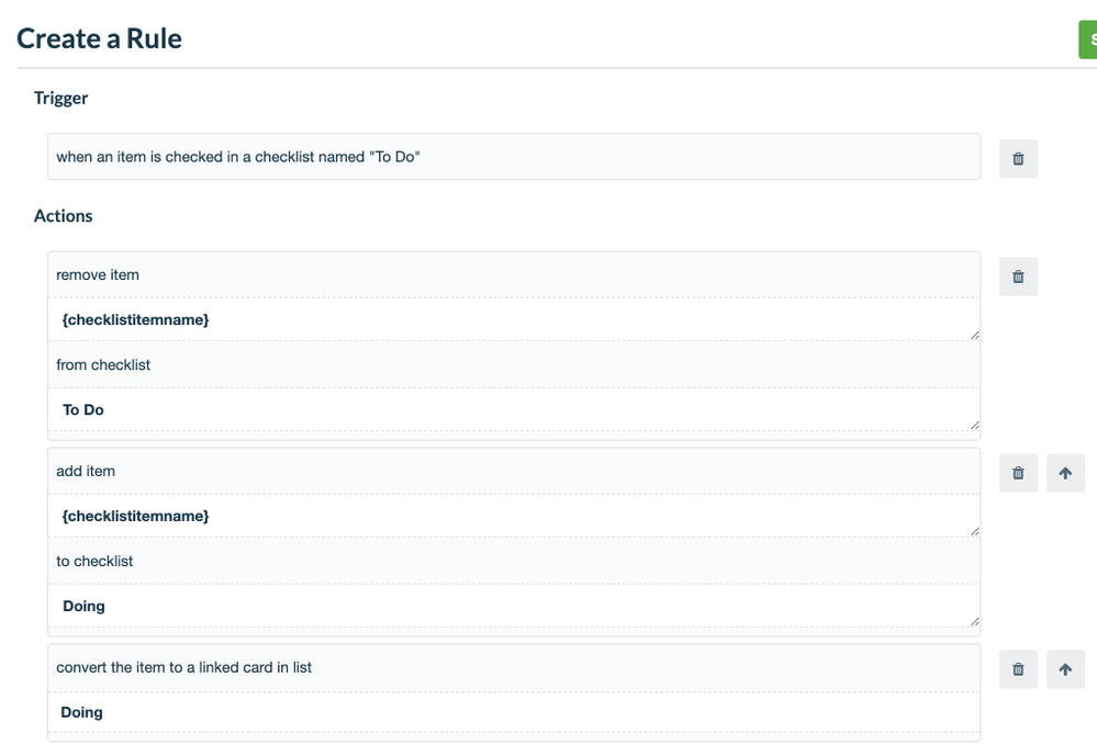

@Lucas Hicks there's no more "when a checklist item is converted to a card" trigger but you can create a linked card when adding a checklist item, or checking an item off.
One option would be to have your checklist called "To Do" then another checklist "Doing" and move items to "Doing" when checked off, linking them at the time:

@Oliver Rathonyi-Reusz you could potentially check the item off and use that as the trigger to convert the item to a linked card, and uncheck the item. Then you'd have a linked item and could check it off when the card is moved to done.
I guess you'd have to find a way to stop that *actual* check event from triggering it again, so you should check that the item doesn't start with "https://"
