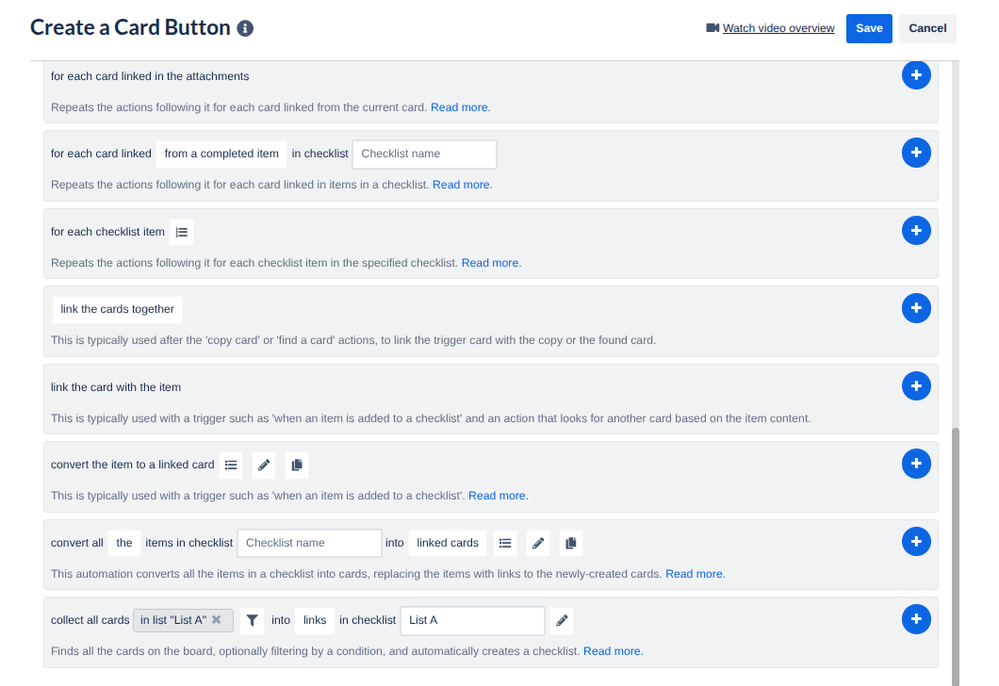

Mike - Dreamsuite Consulting
December 1, 2025
This also can work but you'd need to format the description correctly.
Regarding multipliers, these are only valid for where cards a linked within a card, see the "for each card..." actions from the cascade section below:
You could get the card description or name if the trigger is like I suggested above
Here is the modified version
When a card is added to "List A", find the card "List A Summary" and set the card description to {carddescription}\n ###{triggercardname}\n{triggercarddescription}
The other option is to use smartlinks, which enables you to see (at least a portion of..)the description too:
When a card is added to "List A", find the card "List A Summary" and set the card description to {carddescription}\n [{triggercardlink}]({triggercardlink}) "smartCard-block")

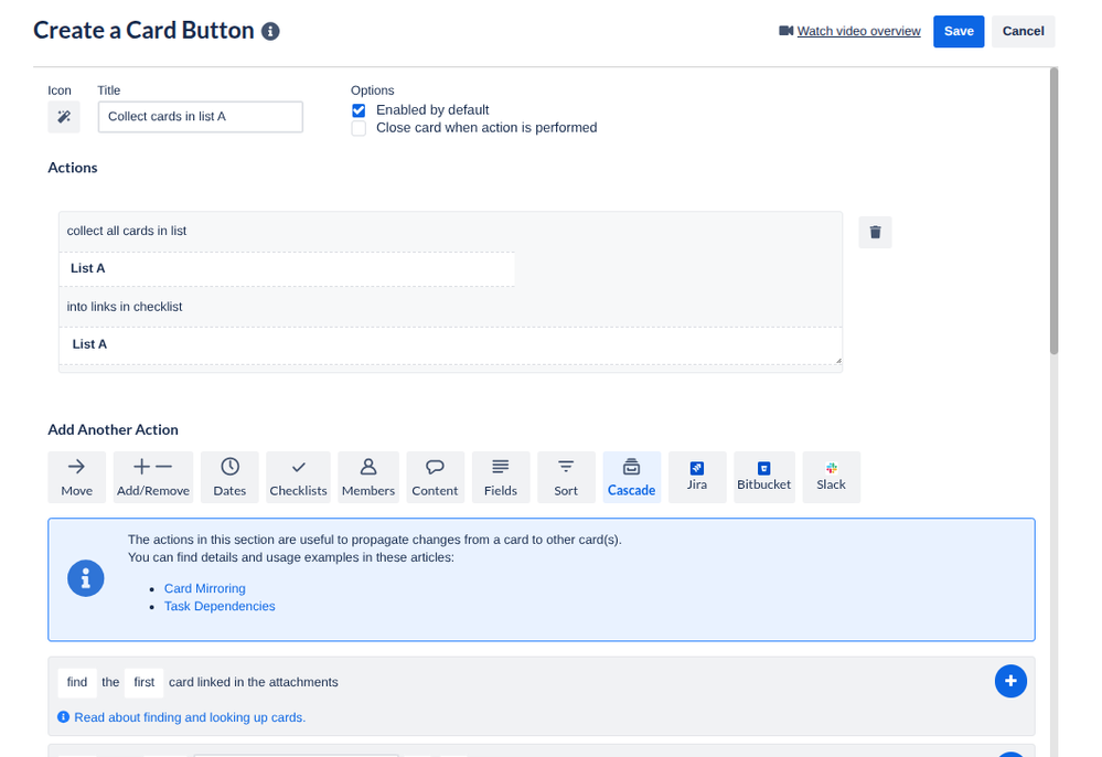

Hi @Ed Schutte
You can use an automation to consolidate all cards in a list into a checklist, if that is helpful?
