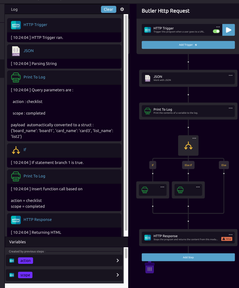

I just came across http request when reading a reply on quotas. Why it excites me?
Recently, I created Superhero Power where registered users can execute pre-tested modules in a Sandbox. It has moved from there to a concept, I called Superhero Basecamp, where the user brings the app in house and execute the code from a board via custom Card button through an endpoint in Superhero Power.
I would imagine you can offload most of the routine processing that way to an endpoint while staying within the rate limits. There is probably no limits on what one can do once the endpoint receives the data....e.g. setup a webhook that will monitors all actions ...do something about them and remove the webhook, or use existing webhook but activate work based on the specific requirements submitted at the endpoint to customise the behaviours etc end of day/week/month processing
Above is conceptual at this moment as I have not tested it. Might just do one today.
milynnus
July 28, 2020
OK. Here's the proof of concept for POST request. Will probably have to build some initial authorisation so that the called endpoint have access to the your boards etc.
