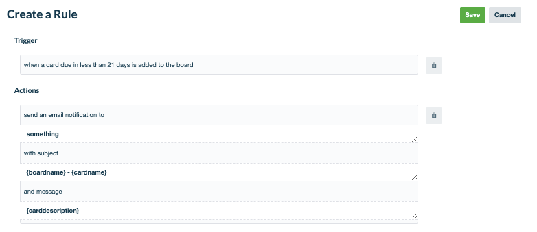

You can do this with a Butler command/rule using the variables found here
If you use that, it could look something like this in Butler:
Screenshot 2019-11-30 at 17.03.13.pngObviously the 'something' would be the email address you want to send it to - but in this example, I have the board name as well as the card name as the subject of the email, and in the body of the email I have whatever is in the card description.
Of course, you can add more or take things away in this way, so I've added the link to all the variables in this reply as well, so that you can see exactly what can be done!
Hope this is helpful
Esme :)

If you already have cards in the board that you want to have emailed to you, or to test whether this works or not, simply either remove the due date and re-add it (it won't work for any card on the board that already has a due date set, you'll need to remove it and add it again), or create random cards with due dates to make sure that they're coming over when they should in the way that you want them to
Esme :)
