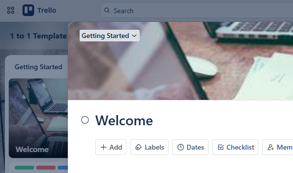

I did a quick test and this is the result..
So I guess it is working :)
