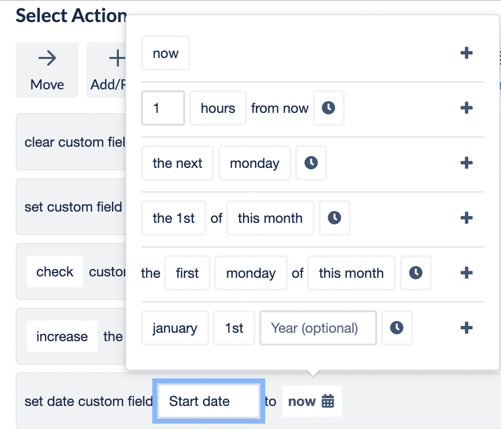

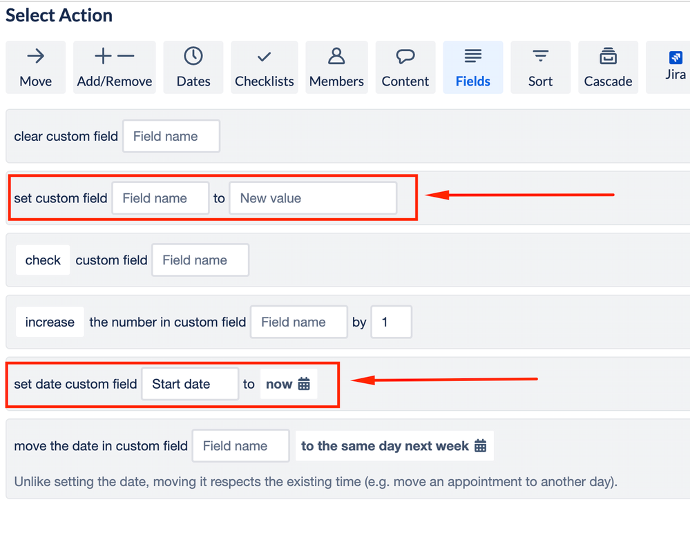

I have tried working on the rule but currently, there isn't any predefined action that fulfills the second part of the requirement.
The set date custom field has only some options available which doesn't seem suitable here.

I am referring to the last part of the scenario here: set custom field "Project End Date" to "{trigger{{%Project End Date}}}"
We have two options to set the custom field's value. The first one doesn't support field type date and the second one has some limited options which doesn't offer setting the custom field using variables.
Shauna Strickland
August 18, 2025
Thank you; that verifies that I cannot automate the desired action.
