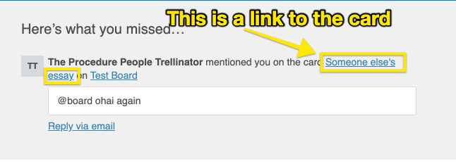

@Derek Seidel whenever a user (other than yourself) posts a comment "@board" to a card the notification will have a link back to the card.
2019-04-29 at 10.26 am.pngThere will be 2 issues with this method:
1) You will need to set up a separate "bot" account to add the power up, otherwise the user who installed Butler will not see the notifications
2) Email notifications are tricky in Trello: if they are read on any other device (web, Trello mobile app) then Trello will not send an email for that notification even if you've got it set to notify "instantly". So if your team uses email notifications at all, then the best thing to do is encourage them to *ONLY* view their notifications via email; that is, disable app notifications and never look in the notification centre in the web/desktop apps. This is really finicky though (I've tried it) and eventually I gravitated back to never using Email notifications because at least if people only ever use app notifications, they are less likely to miss something (and eventually I developed Benko Board to fix the problem of notifications in a more comprehensive fashion)
