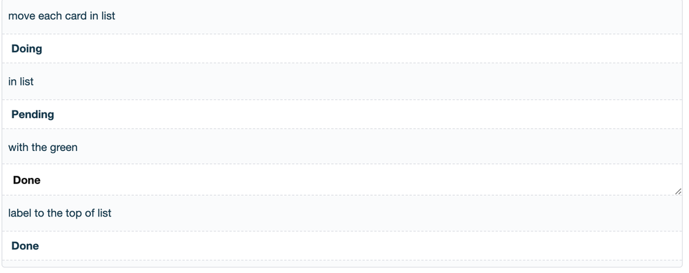

I have a pickle with a butler automation. I've made a board button with the intent to move cards from my two lists 'doing' and 'pending' with the green label 'done' to my list 'done'.
The button works as long as I only move cards from one of the lists to the 'done' list. However, when I individually select both lists under the 'move each card' option. The automation runs but nothing happens.
I've set it up the following way

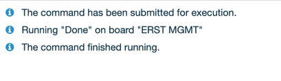

Screenshot 2020-12-10 at 16.44.19.pngyet when I press the button nothing happens. I'm given the following message:

I don't think having multiple "in list" filters works - it's an "AND" filter not an "OR" filter, and because cards can only be in a single list (not in "Pending" AND in "Doing"), Butler won't match any cards.

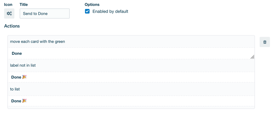

Do you need to specify the list names at all, or would it be viable to just move all cards with the green "Done" label when you click the button?

Thanks for your reply - ok, gotcha. I think your example would work just fine, I will try it out and come back with an answer as to if it worked.
