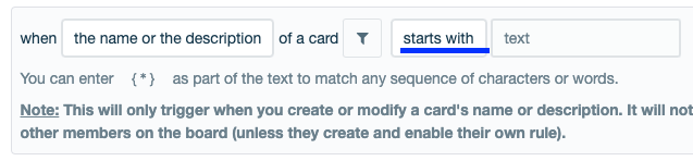

It seems in the Butler Bot days it was possible to have the Trigger simply be "when the name or the description of a card is changed", but that no longer seems to be an option and the closest I can get to it is this:
What I'd love to be able to accomplish is when anyone changes the name or description on a card, it finds the copy of a card on another board and changes the name or description to match.
I'd also be open to to it just sending a message to a Slack channel letting us know a card name or description has been changed. Our system heavily relies on card names, and the description needs to match on multiple boards.
Appreciate your advice!
