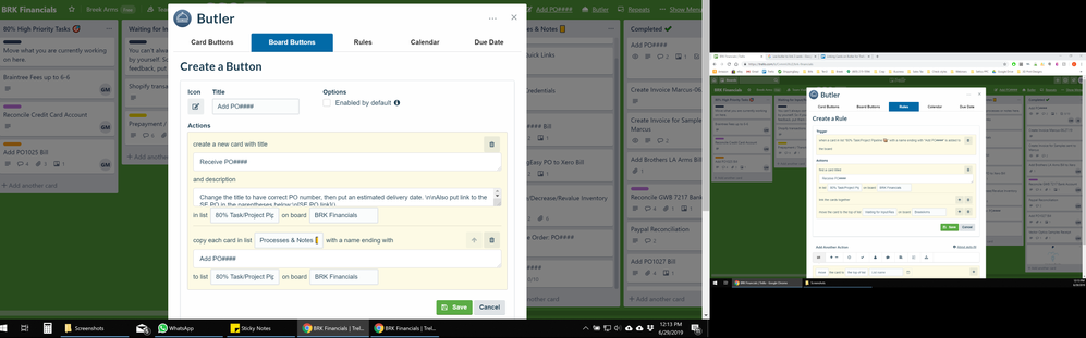

I made a board button that Creates 2 cards (one new card and one is a copy of another card on the board) that I need to complete a Purchase Order process.
What I need to happen next is have the 2 new cards linked together and then have one of those cards moved to another board.
I made a rule that seems like it should do that, but nothing is happening when I create those 2 new cards, even though that is set as the trigger.
Please let me know how I can fix this, or if there is a better way to get the two cards linked with one on a different board. I have tried a couple slightly different ways but each time the rule doesn't do anything.
Button and rule shown in picture below:

Hi Evan, from what I can see the two pictures show the board button only. Can you add another screenshot of the rule?
Evan Meinerts
July 10, 2019
There is only one picture, you will have to scroll to the right to see the rule.

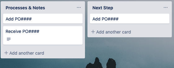

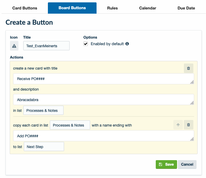

I re-created the board button and I get it to work for the first part. The second creates a copy of an already existing card. Right?
So, I tested this. And it worked. Here's the command I set up:
And this is the result I got:
And this is what you wanted to accomplish, right?
So, comparing my Board Button with yours, I suspect that the icons you are using in your list name is something that Butler cannot deal with and doesn't recognize. -- Can you try and remove them and run your command again?
Let me know how it goes and I'll check back on the 2nd command.
