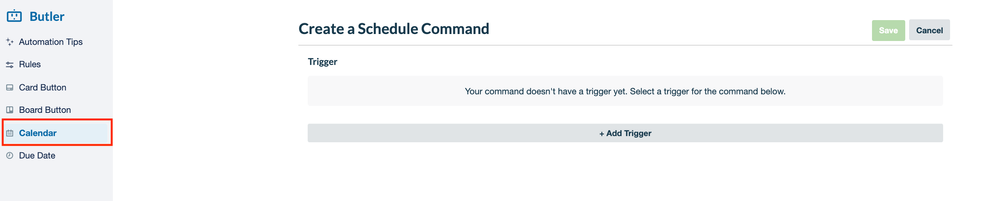

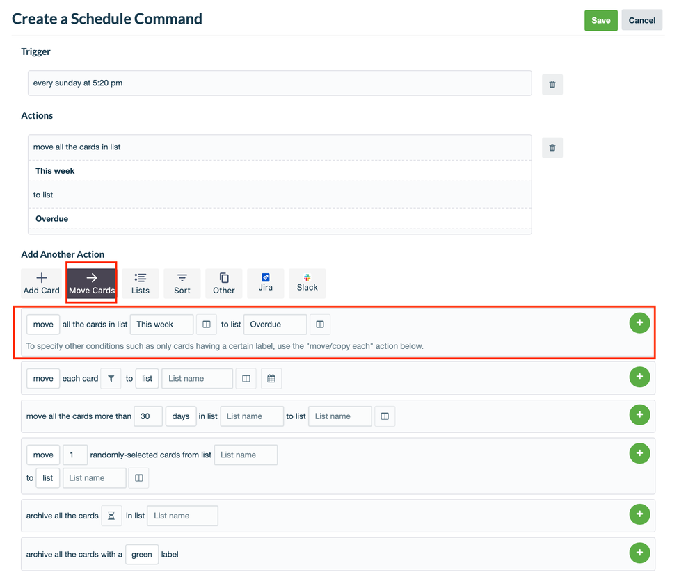

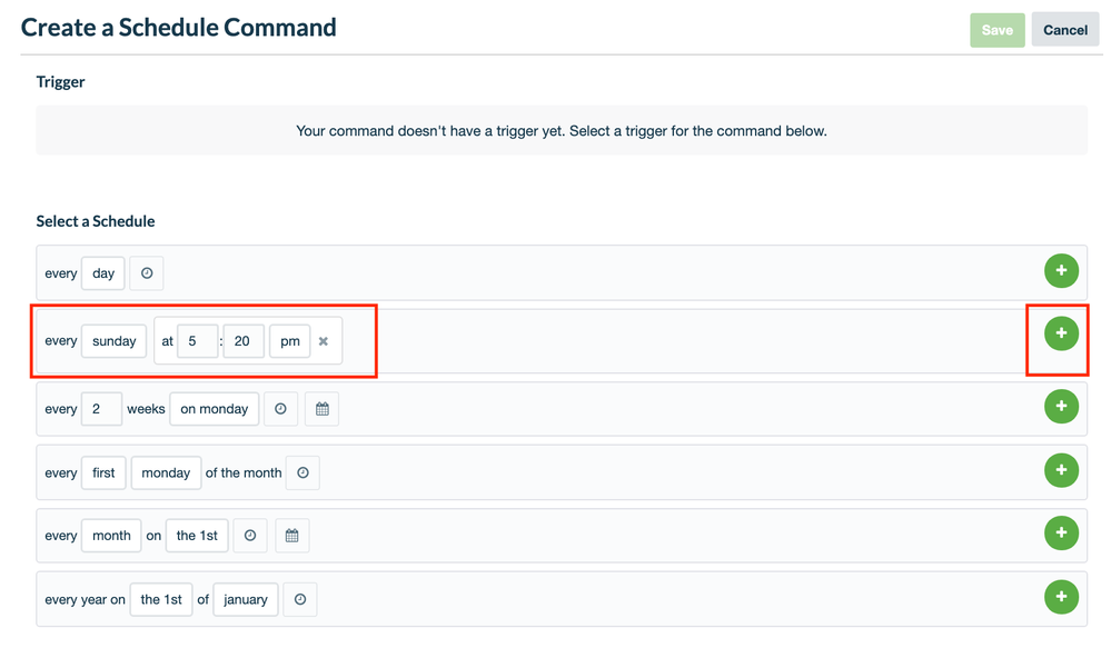

Because you don't set due dates, I would recommend that you set up an 'Overdue' list. Then every Sunday you can have a calendar command that looks like this:
Then:
Screenshot 2020-05-07 at 17.16.26.pngThen:

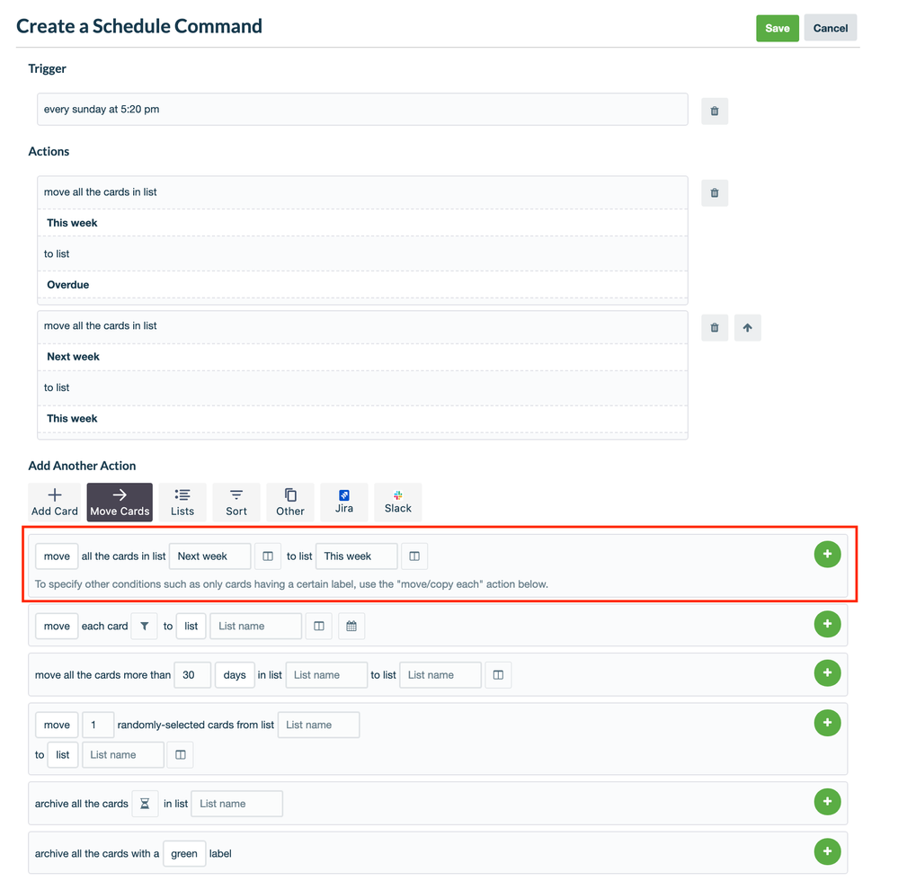

Then:
So that will move all the cards from 'This Week' that haven't been done, into 'Overdue' and then move 'Next Week' into 'This Week' - make sure that these are in that order, otherwise the actions won't work and you'll end up with everything in the 'Overdue' list and nothing in the other two!

If you go to the Calendar section of Butler, you can set a trigger for certain days (Sunday), and then you can tie actions to that. I'm not sure I entirely understand what you're wanting to accomplish, so I can't really help with setting up the right trigger.

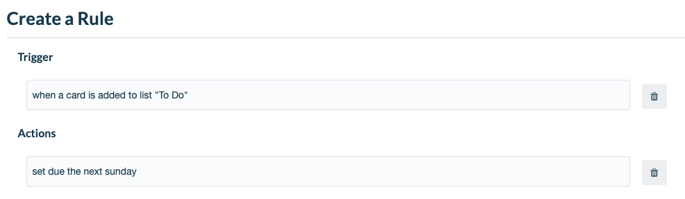

@simon the due date on cards goes red when overdue, and you can also filter cards on the board to show those which are overdue, so using due dates would function the same way as an overdue label, so you can just set any cards you create in a To Do list to be due this sunday and then they'll go overdue. You could optionally trigger a command when the cards become due as well:
