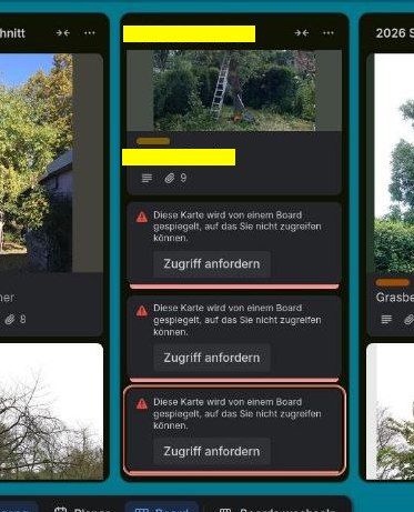

That's exactly what I was trying to do --  but that did not work because my team members can NOT see the mirrored cards. We tested this right away. They sent me a screenshot that shows the mirror cards on their board saying "this card is mirrored from a board that you cannot access" and an "request access" button. (Translation mine, their Trello isn't in English).
See screenshot -- the three in the middle are mirrored cards, the rest are those manual Butler copies.
Is this how it's supposed to be or not?

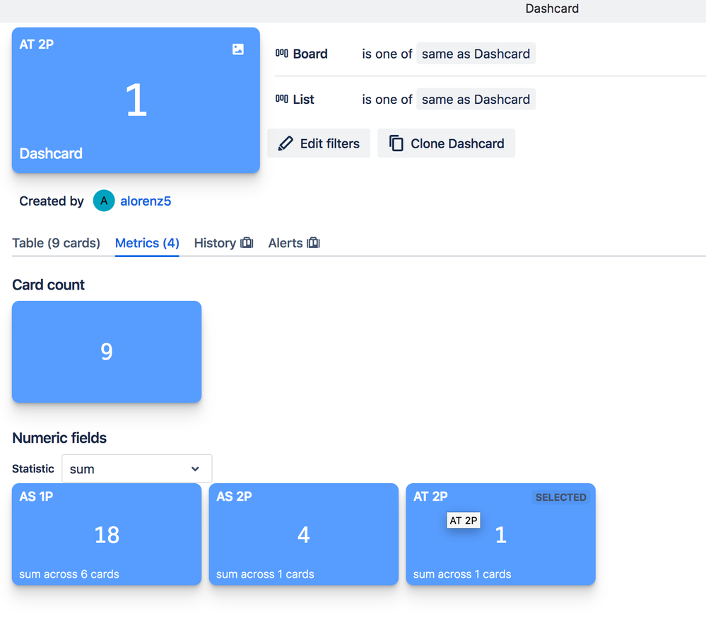

I just tested this again:
- the card "Test" lives on the team board (blue) and is mirrored to mine (green). custom field "AT 2P" has a value of 10.
- the next card (with the completion date) lives on the green board, custom field "AT 2P" has a value of 1. That is the only card in this list that has this field set.
- the dashcard is supposed to be tracking the sum, but it doesnt. All it sees is the value in the second card (and all other cards in this list, if I put something in that field), but not in the mirrored one.
Here's the settings in the dashcard > Explore and edit:
It only lists one card with "AT 2P", although two (one original and one mirrored) have that value set.

Oh, I believe I see the mistake I made with the tracking stuff ...
It is tracking only cards *on the same board as the dashcard*, and THAT is why the mirror cards fall through the cracks. The mirrored card isn't on the same board, only the mirror is. Duh.
When I remove that board filter, it starts tracking a bunch of stuff (duplicates from testing I suppose) -- but the mirrored card is being tracked now, and tracked only once, that is what matters.
"List is one of "same as dashcard"" apparently doesn't mean what it says -- it's talking about the list *name*, not the actual list. So better not have a "2026-Q1" list on every board ...
