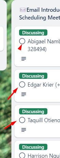

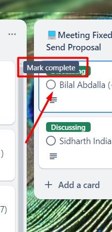

Hello,
I am experiencing an issue in Trello where a "Mark Complete" checklist has suddenly appeared on all my cards across every list.
Despite my efforts to remove these checklists, I have been unsuccessful.
I have attached screenshots that illustrate the problem.
Could you please advise on how to remove these unwanted checklists?
Thank you for your assistance.
Best regards
Piyush

Rasmus Wulff Jensen
February 5, 2025
You can partly turn it off with the following instructions:
Turn off marking cards as complete for a board
Marking cards as complete on the front of cards can be turned off for individual boards via the board menu. If this setting is turned off, you can still open the card and mark it as complete on the top left of the card. Only a board admin can configure this setting.
  1. Open the board menu
  2. Select Settings
  3. Under Complete Status, select Show complete status on card front to turn it off.
(The Trello team is working on even more customizations of this new feature)

Константин Бирюков
February 5, 2025
It seems like you can't turn it off completely. If you do a search in a search input and open your card from the search results dropdown - you are still going to see the card as a checkbox and it will behave as a checkbox even if you have already turned off this feature in the board settings.
