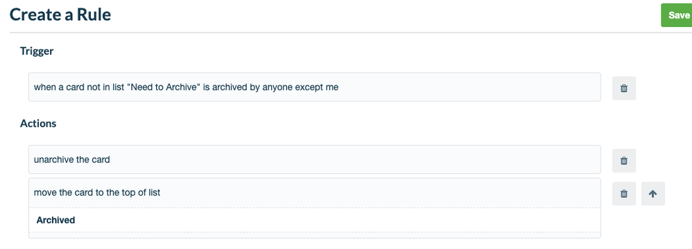

3) One option is to use Butler to do something like this, it will guard against accidents but not malice:
2020-05-13 at 11.23 pm.pngThe reason I put that "not in list Need to Archive" clause in there is if someone actually did need to get rid of a chunk of cards, and say they archived all cards in a list, then it would potentially very quickly exhaust your Butler quota.
If you did find this exhausting your quota, you could do the same thing directly via the API using this Trellinator function:
https://gist.github.com/iaindooley/0228834de00f2519b8eedf7b6d08c388

To avoid cluttering the board with another column, I will manually check the 'archived items' each week to assess if anything new has been put there in error; we do not archive much so this should be sufficient.

@Jack Hagen note that you could also put that archive list on a different board that you can check to avoid cluttering things up, if the archived items solution doesn't hold up.
