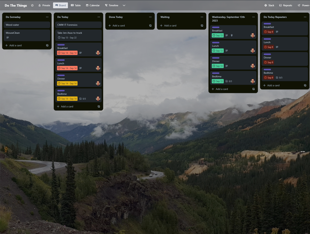

Consider this board, "Do The Things." I record what I have for Breakfast/Lunch/Dinner in the cards while they are in Do Today, and once I'm done eating, I drag them into "Done Today" where a rule marks them as complete. I'd like it to also un-Watch them, but neither Automation nor the API can do that. Oh well.
Then at 0130 every morning, "Done Today" gets renamed to that day's date and a fresh "Done Today" is created. Eventually, I'd probably like to move those to a "Did Today" board and have a master list of all my meals from all my boards. But ok, that's a little pie (heh) in the sky.
My initial idea was to have my daily (or someday, weekly/monthly as well) tasks listed in "Daily Task Repeaters" and have code that copied them with any attributes intact, just modify the dates, set them to uncompleted, clear watch status, etc. But nope, no such luck with the API.
