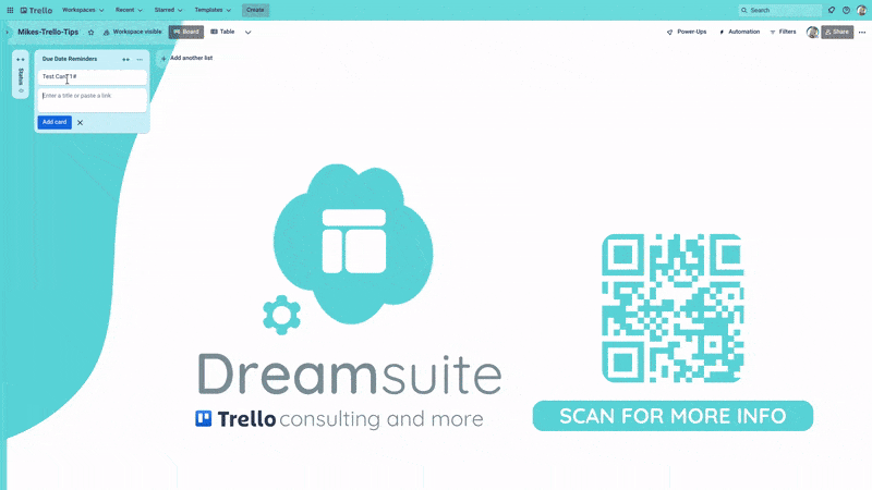

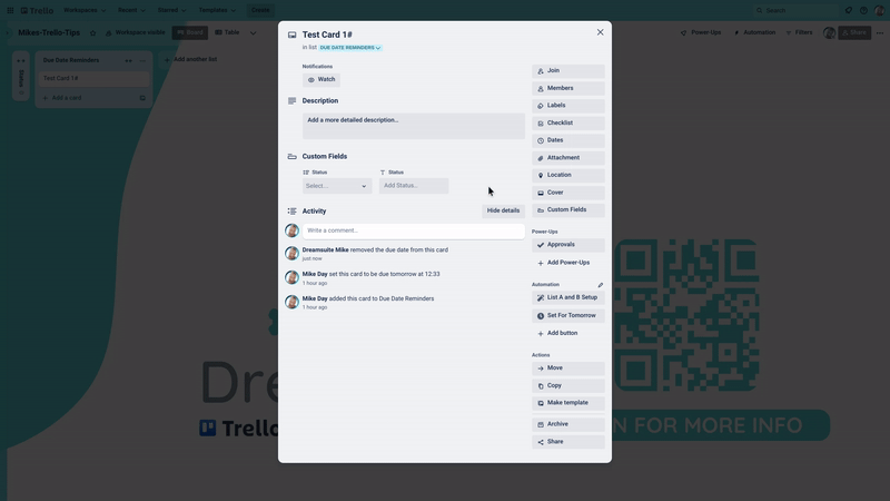

Did you know that when you set a due date on a card, you can set when it reminds you?πŸ””
When you set this, it becomes the default for any dates you set
So,  when a date is added to a card with Automation, power-up, email to board or the Trello API, surely this reminder stays the same, Right??
THINK AGAIN!  The reminder is disabled by default when these methods are used.... (Trello folks, please fix this?!πŸ™)

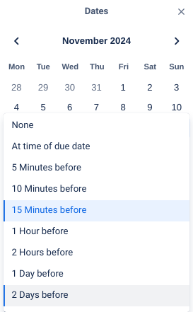

Part 2 - Understand how the reminders work
This is what you see but if you peek behind the scenesπŸ‘€, Trello is setting these values in minutes, like below:
  • None = -1
  • At time of due date = 0
  • 5 Minutes before = 5
  • 10 Minutes before = 10
  • 15 Minutes before = 15
  • 1 Hour before = 60
  • 2 Hours before = 120
  • 1 Day before = 1440
  • 2 Days before = 2880
Now you know this important information, my automation is going to show you how to set the reminder to 1 hour before (60), you can change the automation to your preferred choice.

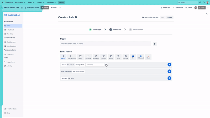

Step 1 - Create the Trigger
For this, we are going to use the trigger
when a due date is set on a card
Step 2 - Create the Action
  1.  Go to the Content Actions Page and scroll to the bottom to find the HTTP request action
  2. Set the action in the drop down to put to
  3. In the URL below,  replace the text PASTEYOURAPIKEYHERE with the API you saved earlier and PASTEYOURTOKENHERE with the Token you saved earlier.\
    https://api.trello.com/1/cards/{cardid}?key=PASTEYOURAPIKEYHERE&token=PASTEYOURTOKENHERE
  4. Copy and paste the URL from number 3 above into the URL field
  5. Paste the following payload into the Payload field
    {"dueReminder": "60"}
    Note: if you want to change the reminder time, here is the place to do it, so if you want it to be 1 day, you can replace 60 with 1440

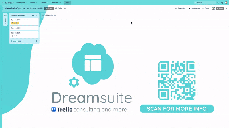

Step 3 - Test

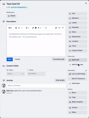

We go back to the automation button from the start and see that now when we click it, it is setting the Due Reminder to 1 hour
