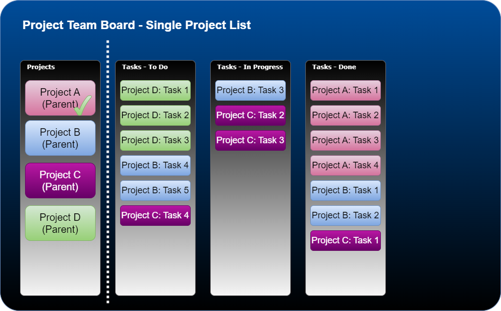

Option 1 - Single Project List and Tasks workflow
In this option, you keep your projects in a list on the left then have your task workflow on the right, with an imaginary line between them:
You can use labels, due dates and stickers to set the status of the projects based on the status of the tasks

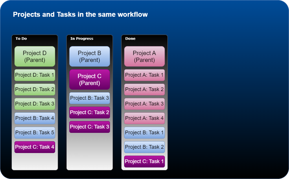

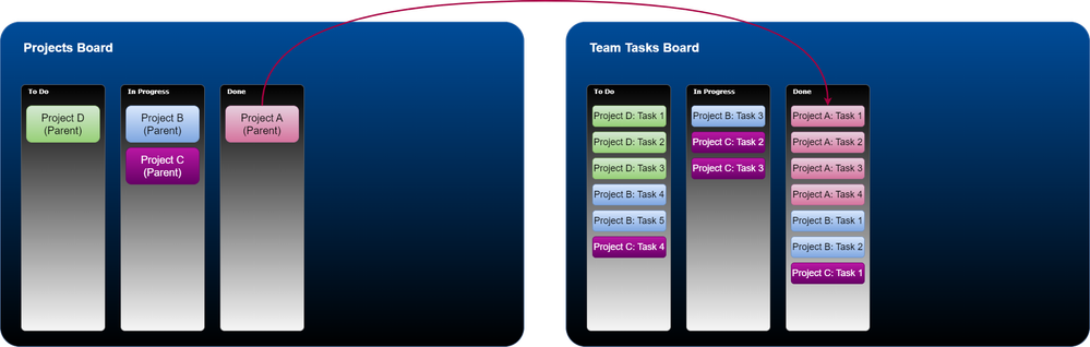

Option 3 - Merged workflow
As with tasks, a project/story/deliverable has the same states of not done, in progress and done.  You let them flow through the same workflow together. You could use labels and filters to display only projects or only tasks.Parent-Child Structure-Page-3.drawio.png
Option 4 - Dual Board
This option is particularly useful if the workflow context is too different between the parent and child that they need different boards.  This allows you to use different custom fields and labels and it also means that the board context is focus around the needs of the particular team.

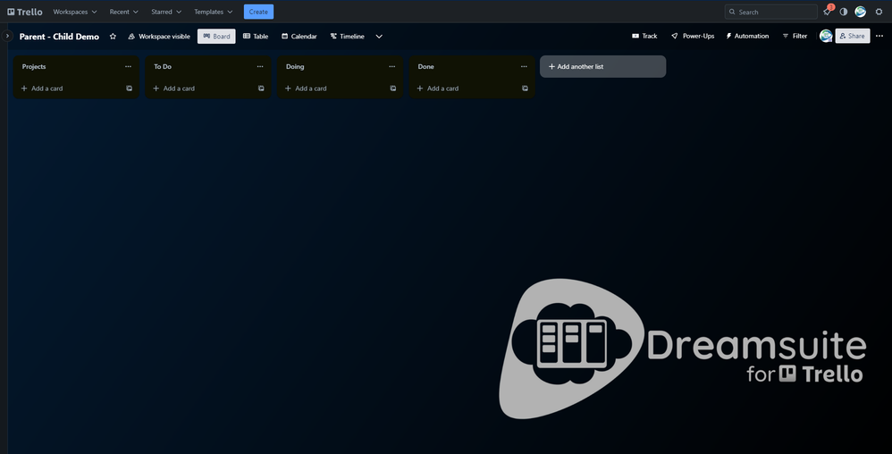

  1. Set up your Trello Board
    Create a Trello Board with the lists as show below:

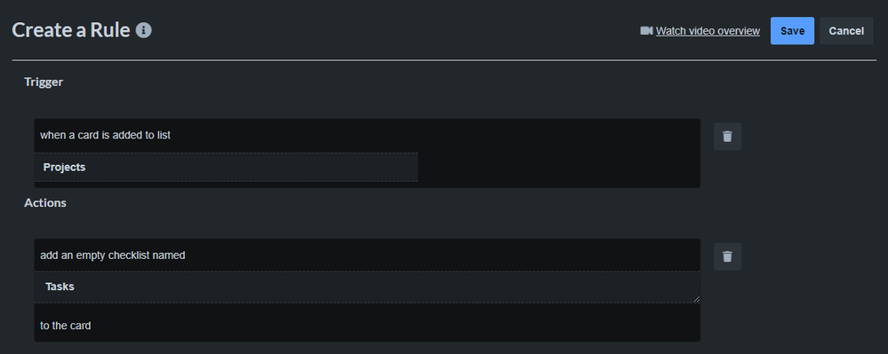

    1. Automation that adds an empty list called Tasks to a card added to list Projects

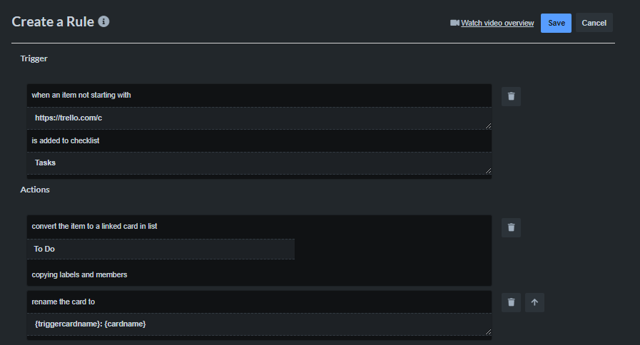

    2. Automation to convert a checklist item into a linked card and rename it with a prefix of the parent card name (this is for filtering)
      Note: the "does not start with https://trello.com/c" is to allow the next automation to work correctly without causing a loop

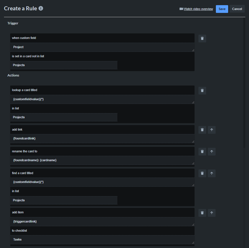

    3. Now, you may want to link the cards at a later stage, this is where the Project custom field comes in.  Automation to link the task to a project when the Project custom field is set

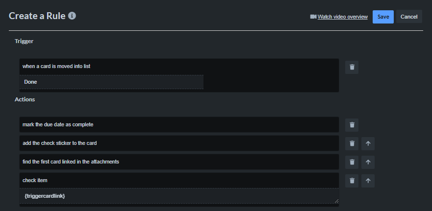

    4. When a child card is moved to done, you want to check that item off on the tasks checklist of the parent card

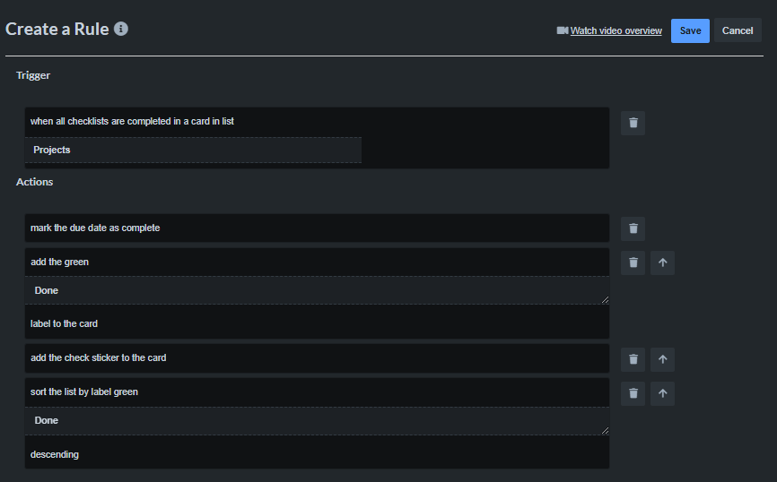

    5. When all the Tasks are complete, this automation will mark the project as complete

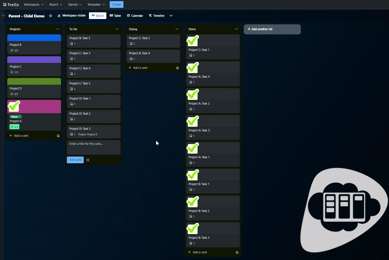

  4. Start Creating your Parent/Child Cards
    1. Create some Project Cards
    2. Start Adding your tasks

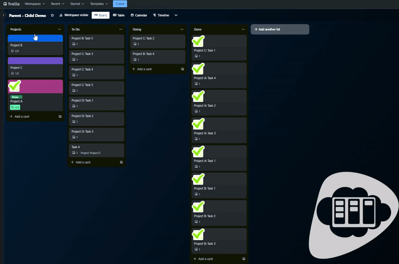

    3. Need to link a new task to an existing project? Use the Project custom field you created to enter the project name...
    4. Need to delete a task? Here are both ways in action...

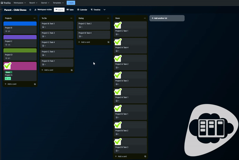

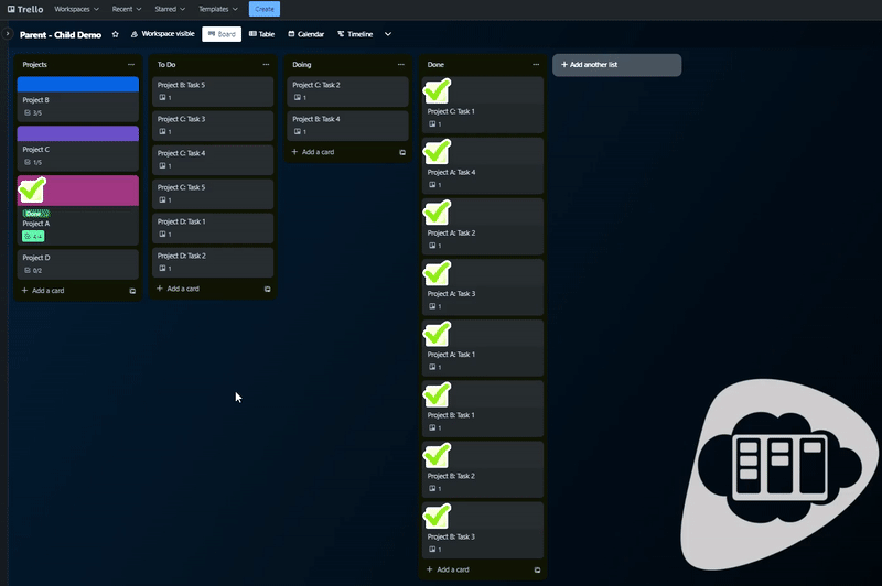

  5. Lets test the tasks going through their workflow and updating the parent card...

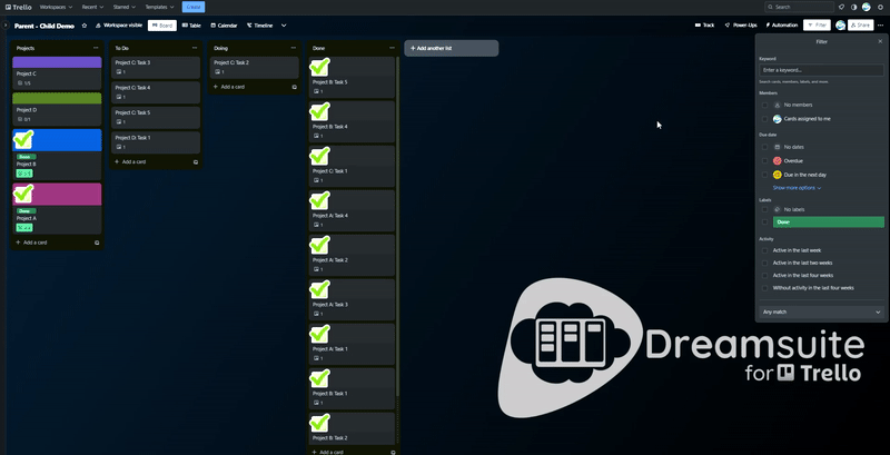

  6. Lets check out how easy it is to filter in this system

When I create a card in "to do" and add the project name in the custom field.
it is not adding to the parent card and for some reason a extra card is made with a link??
This one, I think you can use:
when custom field "Projects is set in a car not in list "Project, look up a card titled {customfieldvalue} and add the attachment {foundcardlink}, rename the card to "{foundcardname}: {triggercardname}, find the first card linked in attachments and add the item {triggercardlink} to checklist "Tasks"
Like ME likes this

October 6, 2023
Thanks for the reply Mike!
where can I find,
"and add the attachment {foundcardlink}"
 I do not see this option in cascade?
Mike - Dreamsuite Consulting
October 6, 2023
add the attachment is found in Card Changes
ME
October 9, 2023
@Mike - Dreamsuite Consulting , ah so it is 2 separate actions and not one?
How would that look in actions?
the way you wrote it looked like it could be confined in one rule.
