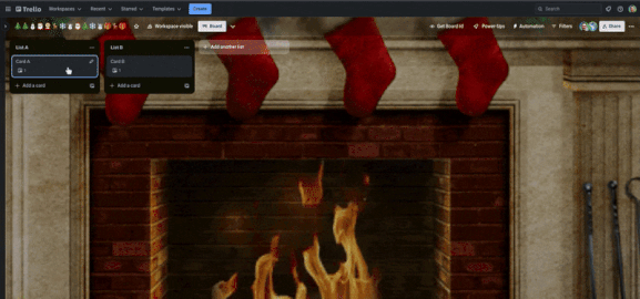

when a card is added to list "List A", copy the card to the top of list "List B" and link the cards together
That is all it takes to start creating linked cards...On to the next step

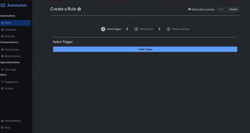

1) Set up the automation trigger

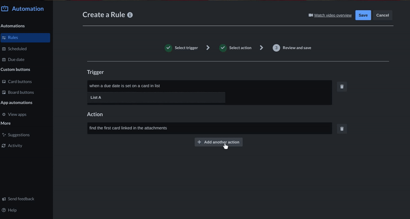

2) Set up the API put
API String
Copy this string into the url box, swapping the bold text with your API key and Token respectively
https://api.trello.com/1/cards/{cardid}?key=replace_this_text_with_your_APIkey&token=r
Payload
Copy this exactly as it is and paste into the payload box
 {"due": "{triggercardduedate}"}
Full Automation (for reference)
when a the due date is set in a card in list "List A", find the first card linked in attachments and put put to url "https://api.trello.com/1/cards/{cardid}?key=replace_this_text_with_your_APIkey&token=replace_this_text_with_your_token" with payload "{\"due\": \"{triggercardduedate}\"}"
