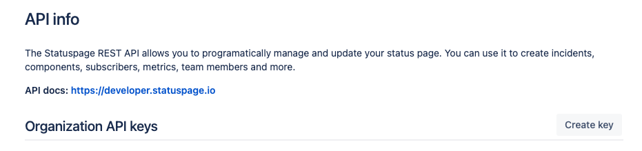

But it looks like you can have more than one API key. In manage.statuspage.io click on your profile avatar in the bottom left of the sidebar.
Click on API Info and then click on "Create Key"
So I think you can accomplish what you are trying to do. However, I don't think you can prevent one key from only being able to update one page and not be able to update a different page. But if you are using automation to update your pages, then using a different API Key and Page ID in your automation, you could get close.
