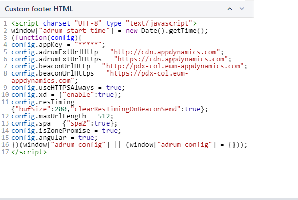

Nick Coates
May 24, 2021
Hi Jamie,
Please add this into the 'footer' in the customization area, not the header. The are referring to add this to the <head> section but we do not have access to customize this.
See attached (I've tested and this works on my own pages).
Thanks,
Nick
Jamie Jenkins
May 24, 2021
Looks to be working as expected, thanks.
