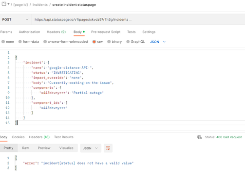

Prasanth dasari
October 24, 2022
Hi Alan,
Thanks for your reply. Yes, I am able to create an incident but not able to update the component. I have given the same component ID which you have suggested and facing error show in image. StatusPagePNG.PNG
Alan Violada
October 24, 2022
Thanks for the update, Prasanth! Can you please try changing the "status" parameter to not be in caps-lock, so "investigating"?
Let me know if that does it, please.
Regards,
Alan
Prasanth dasari
October 24, 2022
Hi Alan,
No, it did not work! This is the error I am seeing now when modified to "investigating" :
 "error": "cannot update component to invalid status"
Thanks,
Prasanth
Alan Violada
October 24, 2022
Hey Prasanth, the issue is now the parameter being passed for the component status here:
"components": {
"k67ffm0s****": "Partial outage"
These are the accepted parameters for component status:
"operational" "under_maintenance" "degraded_performance" "partial_outage" "major_outage"
So in this case, if you set it to "partial_outage" I believe it should fix the error. More details on these parameters, and the API endpoints can be found here:
https://developer.statuspage.io/#operation/patchPagesPageIdComponentsComponentId
Let me know if this works!
Like Prasanth dasari likes this
Prasanth dasari
October 24, 2022
Hi Alan,
Yes it is working now.
Thanks,
Prasanth
