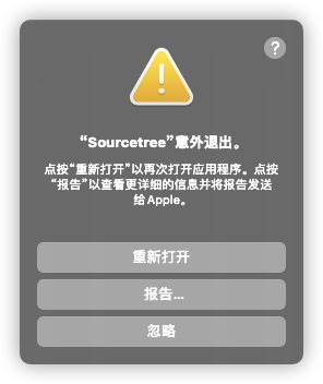

sourcetree Application crashed in 4.1.6 ;Mac 12.3
yin zhang
March 16, 2022
Appliction crash
MacOS 12.3
SourceTree version: 4.1.6
4 answers
Gerke Stam
March 18, 2022
Tried to solve it by removing the SourceTree Application folder and by reinstalling. That didn't help.
However, it was resolved by deleting the SourceTree application including all local data (see e.g. https://community.atlassian.com/t5/Sourcetree-questions/How-to-completely-uninstall-remove-Sourcetree-from-macos/qaq-p/830398).
So problem is most likely in the local preferences data.
A full reinstall worked for me, only thing I had to do is to reconfigure my preferences and add all GIT repositories from scratch.

Having the same crash.

Same Problem here, both with Sourcetree version 4.1.6 and 4.1.7 on macOS 12.3.1
Trying to open any repository immediately crashes the app.

I have the same issue, MacOS 12.3 with Sorucetree 4.1.6.
Problem report from Mac
