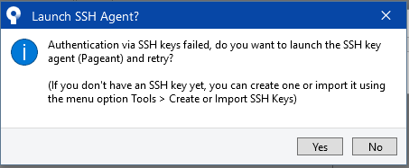

You've tried SSH and it still didn't work? In your original post the URL implies that the URL for the repository is not using SSH. You'll need to replace the origin URL to tell git to use SSH for that repository.
First, go to the repository in Bitbucket, and hit the "clone" button, and copy the SSH url:
Then, open the repository in Sourcetree and paste the URL into the textbox in step 3 (assuming you've setup a SSH key already in Bitbucket and Putty is running):
mattburgett
August 3, 2018
During setup I generate SSH key via Putty under  Tools > Create or Import SSH key. I added SSH key to Bitbucket client.
As stated earlier I downgraded to v2.0.20.1 and things started working again. I decided to upgraded back to v2.6.10.0 and check the settings you suggested.
I did not have to do anything with SSH key as specified above and everything seems to be working now. I did check the settings and see one entry. Settings > Remotes > Name: origin Path: https://username@bitbucket.org/username/directory.git
Deleted user September 13, 2018
I have the same problem but how the heck do I add key after creating it?
OK i found a way to add key but still failed to push
