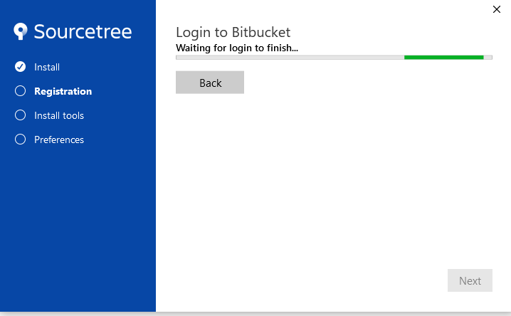

"Use an existing account" login hangs with white screen and "Please wait..." message
kafanasiff@gmail.com January 20, 2017
After installing SourceTree and selecting the "Use an existing account" button to login, SourceTree hangs at a white screen with the "Please wait..." message. The problem persists when trying to log into multiple accounts (any account we tried).
Clicking the "Log in with Google" option does nothing. The button is not responsive.
I am trying to diagnose this issue, can anyone help? SourceTree appears to want to use Internet Explorer as the default browser and someone suggested tinkering with the security settings in there, but that does not seem to work. Feels like a client side issue with my account permissions or something, but the problem occurs even when running the program as an administrator.
Has anybody else encountered this issue? Thanks for your time! Please let me know if there is any other information that would be useful.

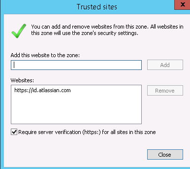

Added https://id.atlassian.com to Trusted sites in IE and worked!!!

I initially added https://id.atlassian.com to my local intranet group, and my next attempt showed me that it was trying to get to https://id.atlassian.com from https://auth.atlassian.com.  I added both urls to my trusted sites and was able to log into sourcetree finally.

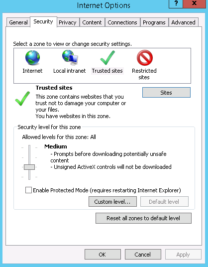

The solution to my problem was changing the security settings of microsoft internet explorer from high to medium.

I achieved success in a similar fashion by adding https://id.atlassian.com to the Trusted Sites list in IE.Internet Options.Security.Trusted Sites.Sites. (SourceTree 1.8.3 on Win2012R2)
TIP : Open IE on your target workstation/server and try to log into id.atlassian.com yourself. If you cant log in then the SourceTree cant either.

Change the security settings in the internet explorer to low
