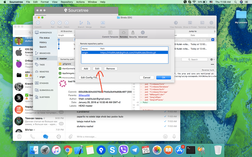

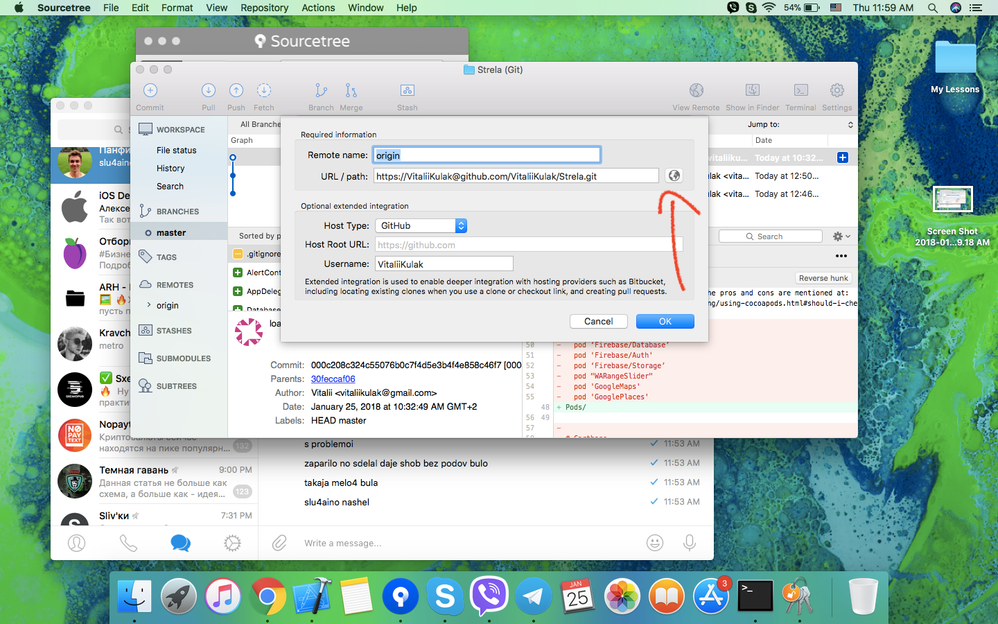

Vitalii Kulak
January 25, 2018
Hello gyis ,i have one solution to help me ,you need only to set url like on photo,if u use https ,push button and shose your poject and url chosed by program.Screen Shot 2018-01-25 at 11.59.43 AM.pngScreen Shot 2018-01-25 at 11.59.18 AM.png

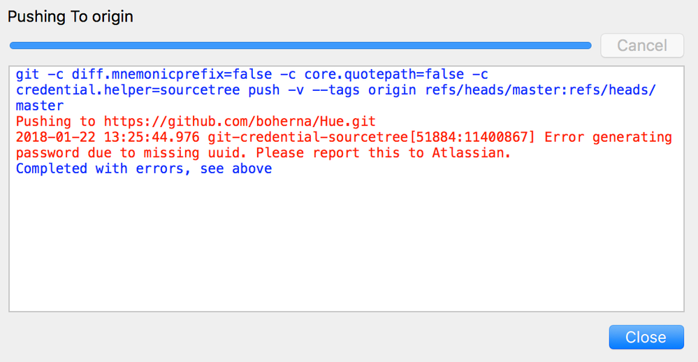

boherna
January 22, 2018
I have the same issue and deleting the com.torusknot.SourceTreeNotMAS.plist didn't solve the problem :-(
FYI: I'm using SourceTree 2.7 (152)

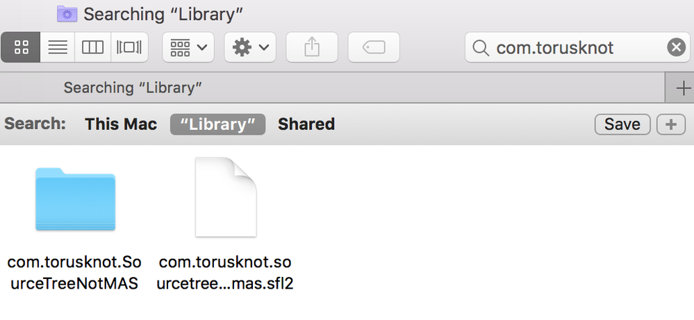

Manju
January 19, 2018
I'd recommend you to delete the com.torusknot.SourceTreeNotMAS.plist located at ~/Library/Preferences/ and launch the app again. This should generate the missing UUID and allow all actions thereafter.
Thanks!
