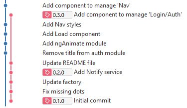

I have a project with some commits. When I started adding tags to this project I noticed it started to create new "branchs" automatically in some tags. Not all of the tags does this, and it's also not an actual branch, but it displays some different colors, which is making me confused.
See these images below:

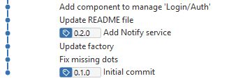

Before adding tag "0.3.0":
After adding tag "0.3.0":
As you can see, it created a new color/line, kind of representanting a new branch in paralalell. I don't know what I may have done that caused this, but I'd like to be able to create new tags and keep only one branch.
Also, depending on the number of tags I add, it can have more lines/colors. At one time I had 6 different colors.

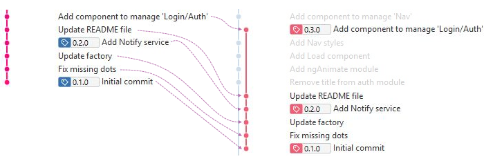

Hello! It looks like those are actually 2 different branches (keep in mind that colors are not always the same for each branch). If you look at the commits in the first picture, you can see they're actually the same commits as the pinkish color line in the second picture. Here's a img with the blue line faded out, and the orginal line colored to be pink:
Hopefully that clears it up.

To add on this comment, when I remove all the tags, it stays like the first image, just one "branch"/color and everything in order. Just like it was supposed to be.
