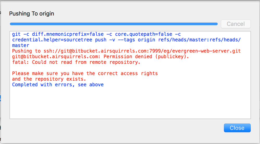

I've got the same problem. Push from terminal works fine (asks for the SSH private key password). SourceTree doesn't ask for the password. Fetch operation works (this time ST asks for password but doesn't remember it in the keychain).
git -c diff.mnemonicprefix=false -c core.quotepath=false -c credential.helper=sourcetree push -v --tags origin refs/heads/***:refs/heads/***
Pushing to git@***.git
Permission denied, please try again.
git@***: Permission denied (publickey,password).
fatal: Could not read from remote repository.
Please make sure you have the correct access rights
and the repository exists.
Completed with errors, see above

I'm having this same issue. I'm able to git push from the command line for the pending Sourcetree push request without issue using the same SSH key with password. I'm on 2.7 (152).Messages Image(3025968649).png
