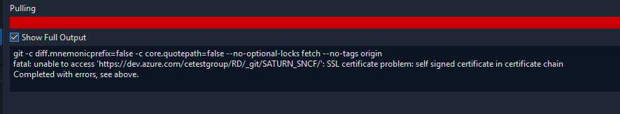

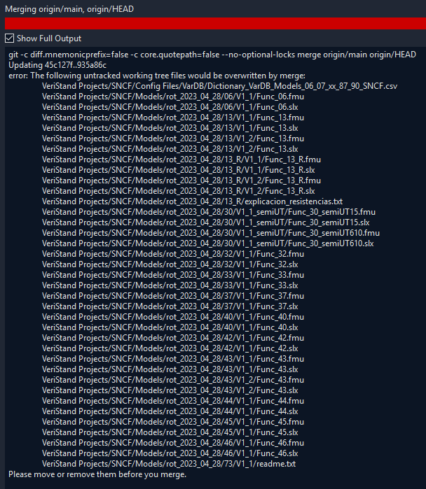

The problem appears in this very moment, since I have done it from a Virtual Machine and the changes do not seem to update accordingly when I do so from another host. The situation is the one appearing on the screenshot and I want main to be in-line with the origin tags. How can I do so?
Whenever I perform Pull the system gives an error regarding the signed certificate, whereas Merge performed right on the first branch deploys another error due to uncommited changes that I have already done in the previous commit.

The pull error is not a Git problem. Your remote is Azure DevOps, and the self-signed certificate in the certificate chain message almost always comes from a corporate proxy or antivirus doing TLS inspection on that VM. I would ask IT for the company root CA file and point Git at it instead of disabling verification, in Sourcetree under Tools > Options > Git, or on the command line with git config --global http.sslCAInfo <path-to-ca.pem>.
The merge error is different. Those .fmu, .slx, and .csv files exist untracked in your working copy and also exist in the incoming commits, so Git refuses to overwrite them. I would move that folder aside, run the merge again, then compare. If those files are generated model outputs, they probably belong in .gitignore rather than in the repo.

As for the moment, what I'm doing is to delete the ones that are reporting an error/discarding the changes made since it has to do more with internal testing for keeping the same paths.
