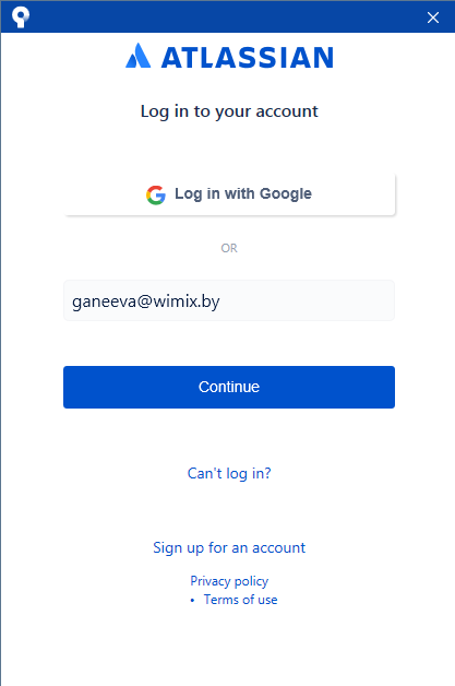

Hello Ana, I'm facing the same issue right now.
I enter my email, which I use for signing in Jira, press Continue. Progress bar appears on top of the button for a couple of seconds and that's all, nothing changed in the window, I can't enter the password.
The same behaviour if I press "Log in with Google". Nothing happens, no error.

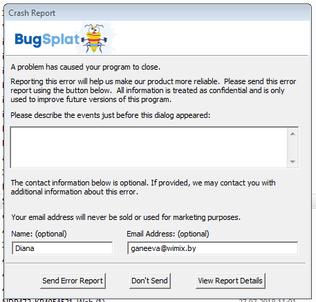

But sometimes program crashes after I close the main window, I sent bugreports when program asked.

the problem solved after I updated IE from 9 to 11. Perhaps old IE can't load password field.
