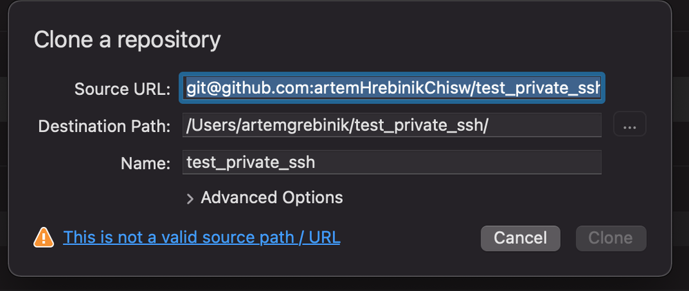

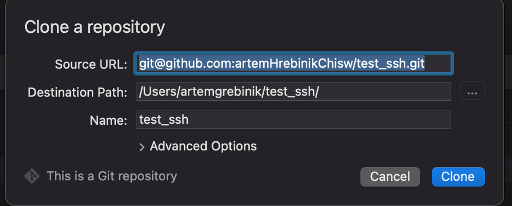

Artem Hrebinik
April 23, 2021
I have the same problem
I can see all repositories and clone only public repo
I connected Sourcetree to GitHub using token and ssh key.
Anyone knows Why is it going and how to fix it?
Снимок экрана 2021-04-23 в 20.32.45.pngСнимок экрана 2021-04-23 в 20.36.06.png
