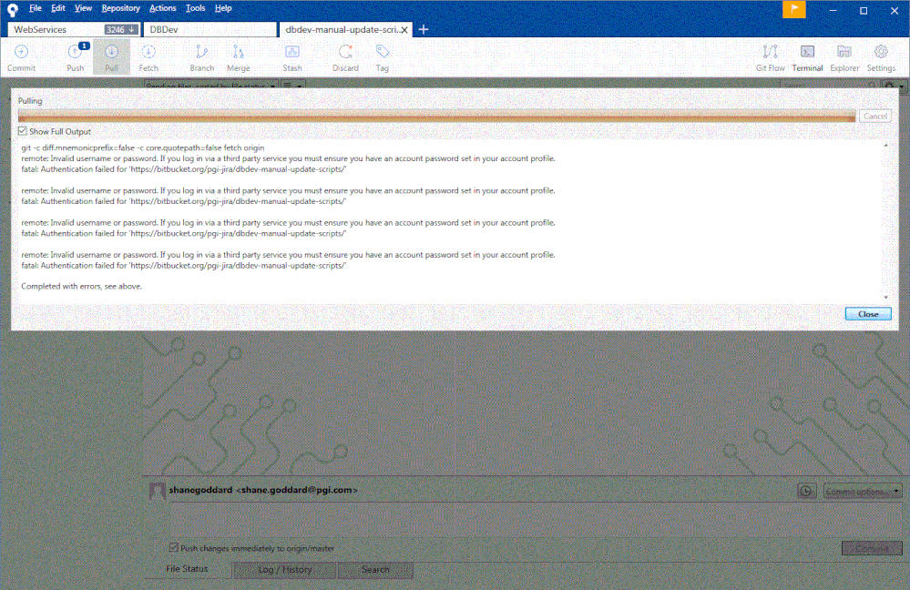

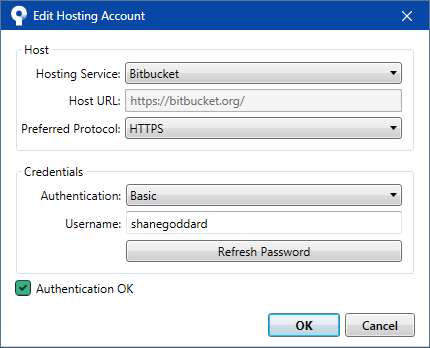

shanegoddard
February 7, 2018

I CAN get the Authentication to work using HTTPS and SSH.  As well as Basic and OAuth... it authenticates there, but as soon as I try to pull OR push it fails.

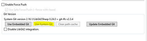

Did you set Sourcetree to use System Git after installing it?

I was missing a step...  I did the use System GIT and did the clean thing again, it asked for the URL, I put one of the 10 in and bam... it asked for my password.
