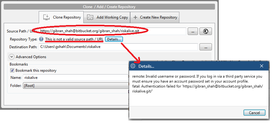

I'm working in SourceTree and I cannot clone my repository. Here's what I enter into the dialog:
But it tells me "This is not a valid source path / URL". When I click on the Details button, it tells me "Invalid username or password...".
I have confirmed that the url is correct and that my username is correct. I'm trying to figure out how to supply the password. Can you please help me figure out how to supply the password.

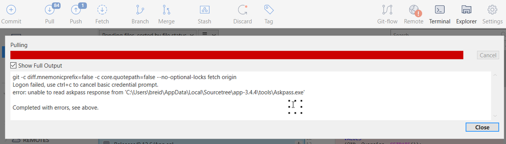

bella brown
May 5, 2021
Hello -- I'm also encountering this issue when trying to connect to github when using sourcetree. Do I need to use a URL with my username in it? If so, what's the format that I should use?
