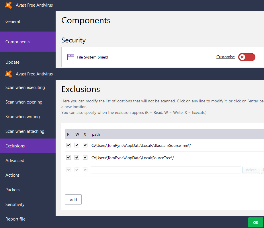

Interesting, I did as you said and could not find a box listed under E, instead I had the options "R" (Read) "W" (Write) and "X" (Execute). I assumed that the "E" you mentioned would likely also mean execute in this context. However, I have not noticed any difference in the issue using these instructions so I'm going to trust your judgement and assume I have not followed them correctly.
Another difference I have noticed is "Protectin FileSystem" is not an option on my components list, but instead "File System Shield" was the component in which I modified the exclusions.
Note in the screenshot I currently have my file shields disabled as I'm working on a project right now.

I solved the issue as follows:
1) open Avast
2) go to the panel Settings\Components\Protectin FileSystem\Exclusions
3) add C:\Users\LOCAL_USER\AppData\Local\Atlassian\SourceTree\* and check only "E"
4) add C:\Users\LOCAL_USER\AppData\Local\SourceTree\* and check only "E" too
