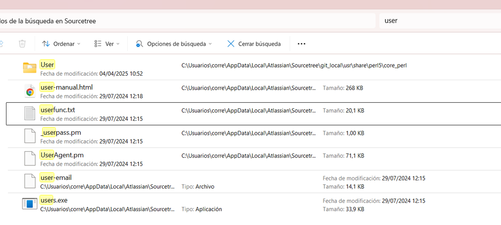

Thanks Tomislav!
Looks like the path "%localappdata%\Atlassian\Sourcetree" per-se does not have that file

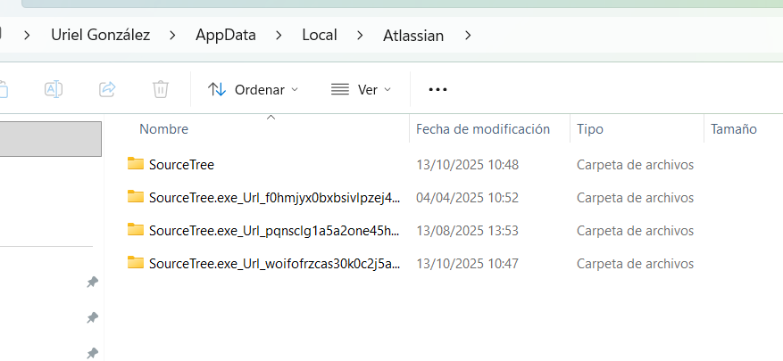

But googling a bit I found out that there should be some other folder(s) under
C:\Users\<username>\AppData\Local\Atlassian\SourceTree.exe_<random_string>\<version_number>\
Found them and deleted the user.config file inside the most recent one:
Reopened aaaaand didn`t work.
Tried again removing every user.config file inside every folder aaaand. It worked!
Thanks, I hope the try-and-fail narration helps someone else someday.
