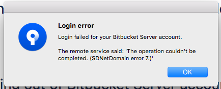

Sourcetree cannot login to personal Bitbucket Server. I get the following error:
Login failed for your Bitbucket Server account.
The remote service said: 'The operation couldn’t be completed. (SDNetDomain error 7.)

Robert Medina
March 16, 2018
I ran the command and followed the steps involved and this is what the log file printed out:
2018-03-16 17:37:20 +0000 () [AUTH] signing out of Bitbucket Server account
2018-03-16 17:37:20 +0000 () [AUTH] Removing the token available in the client before re-authentication
I verified that the keychain for the account was added after I created the new account and tried logging in.
On SourceTree the error remains unchanged.
