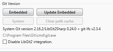

After installing TortoiseGit 2.6 I was able to clone/push/pull with both SourceTree 2.5.5.0 and TortoiseGit.
You're correct about the "System Git" path.  It was pointing to: C:\Users\username\AppData\Local\Atlassian\SourceTree\git_local\bin. After changing the path to C:\Program Files\Git\cmd in the Environmental variables Sourcetree recognized it.
