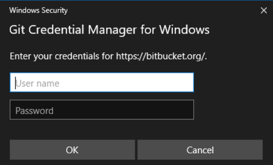

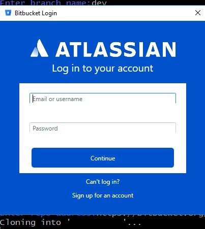

Below are examples of what is going on. Thanks for any info you can provide!
Here I'm cloning from command line, I leave it blank and close out:

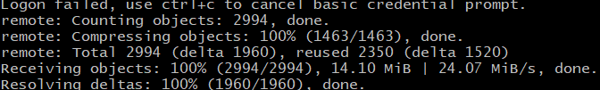

It says the login fails but then proceeds:

If I enter in a password it keeps prompting as you have stated. After removing the passwd file it gives me two different prompts. If I try to enter in credentials on the first one it just keeps looping. So I skip the first one and enter in credentials at the second prompt. (First prompt being what you see a screenshot of in my original post.)
This then creates a new passwd file again. If I close out of the second prompt after removing the passwd file then it will not allow me access at all. However, it will only prompt once if I leave the box blank and close out of it. From there it is able to process the command.

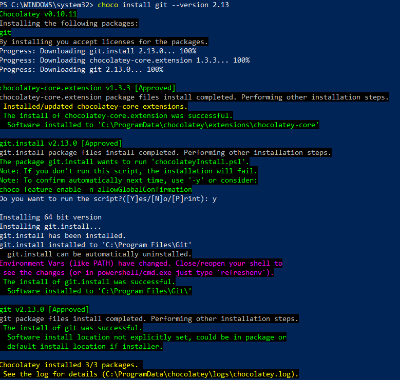

Step 1: Install choco, see https://chocolatey.org/docs/installation
Step 2: run choco git install --version 2.13 in elevated PS prompt:

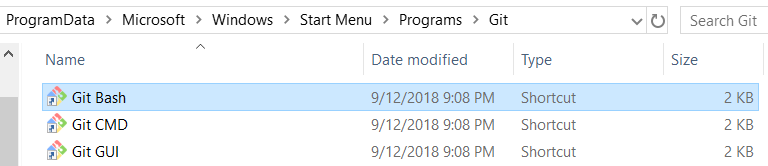

Need to investigate why this install applies all Windows options although I've tried through the git install and still had issues. However, no desktop icons auto so you have to search:

This is what is different. I get this prompt, instead of the Atlassian prompt while connecting to bitbucket as posted above. Which is why I conclude this is a Git issue now. Also notice it's using https but after this prompt automatically getting me setup for SourceTree and beyond.

I have been able to confirm that Git 2.18 prompts with the Atlassian login without having anything Atlassian installed thus the confusion on where the issue was coming from while not knowing if Atlassian ever truly cleanly uninstalled. Could be that it's connecting to Bitbucket and going from there.
What I've done so far:
Installed Git 2.18 on a VM. This is the same version that my computer is on currently.
Result: Same issue! Without SourceTree installed it gives me the prompt shown in the screenshot and same result of not having to enter in the password. Yet prompting any time when interacting with the repo.

Installed Chocolatey (to avoid navigating githubs releases page)
Ended up installing Git version 2.13 with:
choco install git --version 2.13
