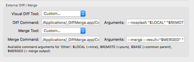

Jonathan Oliver
November 7, 2018
Even when I edited the .gitconfig diff tool path and fixed it by removing portion of the path, each time I'd restart DiffMerge, it would reappear.
/Applications/DiffMerge.app/Contents/MacOS/DiffMerge/Contents/MacOS/DiffMerge
So, here's the workaround.
1. Symlink DiffMerge to another location (so it's not auto-detected as DiffMerge)
ln -s /Application/DiffMerge.app /Applications/_DiffMerge.app
2. Then select a custom diff and merge tool arguments.
Diff command arguments:
--nosplash "$LOCAL" "$REMOTE"
Merge tool arguments:
--merge --result="$MERGED" "$LOCAL" "$BASE" "$REMOTE"
After this, SourceTree will no longer mangle the path at startup because it doesn't think it's DiffMerge anymore.
