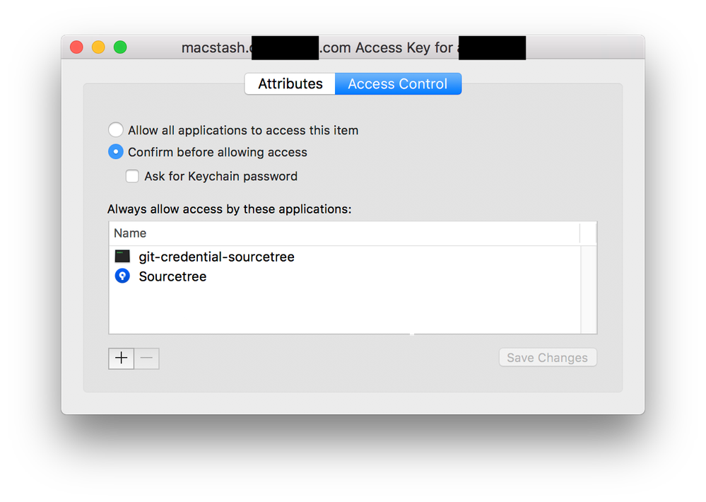

An access prompt for that particular keychain item must come up ideally. Just because Sourcetree wrote it doesn't mean it has access to it. Just to test, under access control of the keychain item, can you set "Allow all applications to access this item" and see if it helps?
Key Access does prompt for allowing SourceTree access to the keychain and the entry does allow sourcetree access. Seen in picture below
Also, Remote Repositories do populate however when I go to clone them is when I receive the error below.

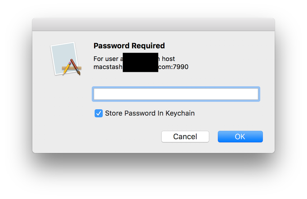

Also, can you specify if you are using https or ssh?
Thanks!
HTTPS and I've ran the command and I see it in the plist but I'm not seeing any additional logging. Should this also be loging in the ~/Library/Logs/SourceTree directory?
