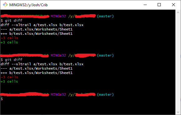

I have discovered https://www.xltrail.com/client which is an open source Git command line extension: git-diff and git-merge.
It seems to work great from the git command line.  However, I am used to using SourceTree.  Anyone know how I can merge these two together?

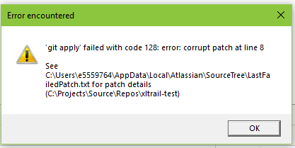

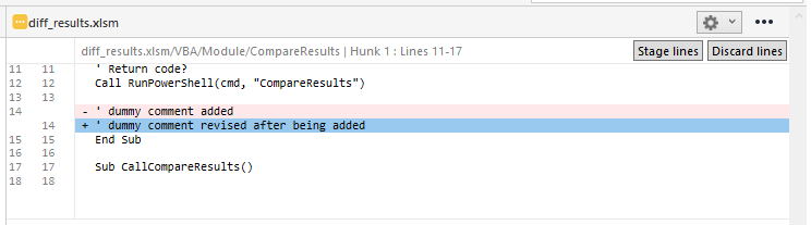

Everything seemed to be working swimmingly, but I ran into some trouble when I edited a VBA module in one of my xlsm files and then observed it in Sourcetree.
2.pngWhen I try to stage or discard lines/hunk, I get the following error:
The content of that file is:
diff --git a/diff_results.xlsm b/diff_results.xlsm
--- a/diff_results.xlsm
+++ b/diff_results.xlsm
@@ -11,8 +11,8 @@
' Return code?
Call RunPowerShell(cmd, "CompareResults")
[31m-' dummy comment added
[32m+' dummy comment revised after being added
End Sub
 Sub CallCompareResults()
I verified that I could discard hunk with a change to a simple text file, so I think my basic sourcetree and repo setup is right.  Perhaps xltrail doesn't support patching like this?  Or might something else be the problem?

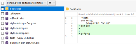

Open the Process Log (Tools > Process Viewer...), click on the file to generate the diff, and then check the process output. It should look something like this:
[1mdiff --xltrail a/Book1.xlsb b/Book1.xlsb
[1m--- a/Book1.xlsb/VBA/Module/Module1
[1m+++ b/Book1.xlsb/VBA/Module/Module1
[36m@@ -2,3 +2,7 @@
'test1
Sub test()
Debug.Print "hello1"
[32m+End Sub
[32m+
[32m+
[32m+gsdgdsg
fzumstein March 27, 2019
Hey @Mike Corsaro , I think what might happen is that @Kade333 is looking at two historical commits, while you're looking at pending commits (where it works). Is there anything we'll need to change (I am one of the maintainers) to make it work for historic commits, too?
Mike Corsaro
March 27, 2019
@fzumsteinnothing you need to do on your side -- looks like 'diff-tree' doesn't have the default diff settings of '--ext-diff' like 'log' and 'diff' does for some reason. I'll add it to our backlog and hopefully it will be included in the next release.

Mike Corsaro
April 30, 2019
It's been fixed in 3.1.3 which is at 25% in our progressive rollout. You can also manually download it here.
