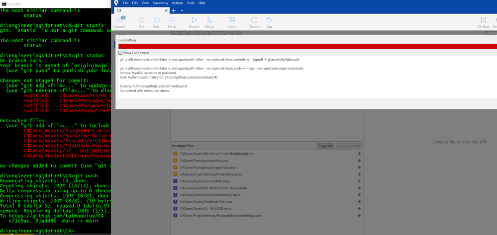

I am having troubling configuring SourceTree.  I have repo already on the harddrive.  I installed git and SourceTree.  I made some changes in the repo.  I tried pushing the changes to the repo using SourceTree but it gives this error.   Git push from the command line works just fine.
In Options - Authentication, I have my account set as ssh.  I have putty loaded and my certificate loaded in putty.
Not sure what to do or what the problem is....
Thnx

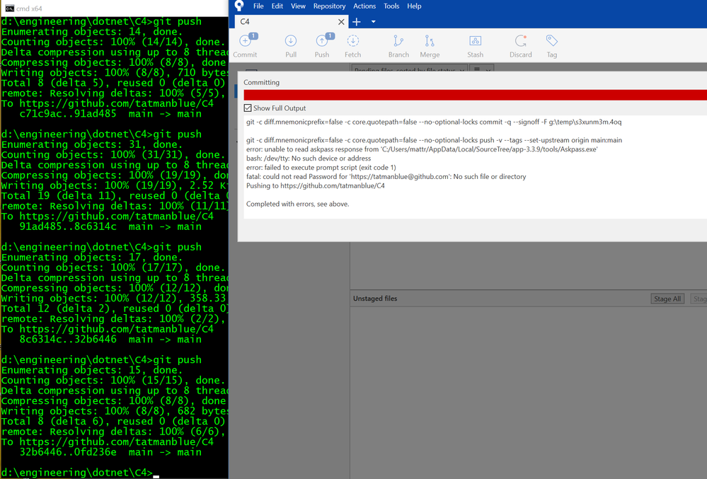

I did have a passwd file in AppData\Local\Atlassian\SourceTree.  I deleted it.  When I pushed my change it prompted for a password which I cancelled and push failed.  Slightly different error.

I think you are having similar problems like me as you are using the old password method to github. Password method no longer works. Use these steps and it should work.
1 - google out the location of your system files. From your path, i think you are also using windows. I won't know which ie. win 7, 8, 10 etc.
2 - uninstall, then go to these location, delete the system files completely.
3 - Restart of computer not required. Go to this link https://stackoverflow.com/questions/57013397/how-to-make-a-basic-connection-to-github-in-sourcetree. This should solve your problem. It did solve mine.
Tell me if this doesn't work. I believe git for sourcetree might not be working as the configuration is just no longer there.

However, the personal access token did work.
