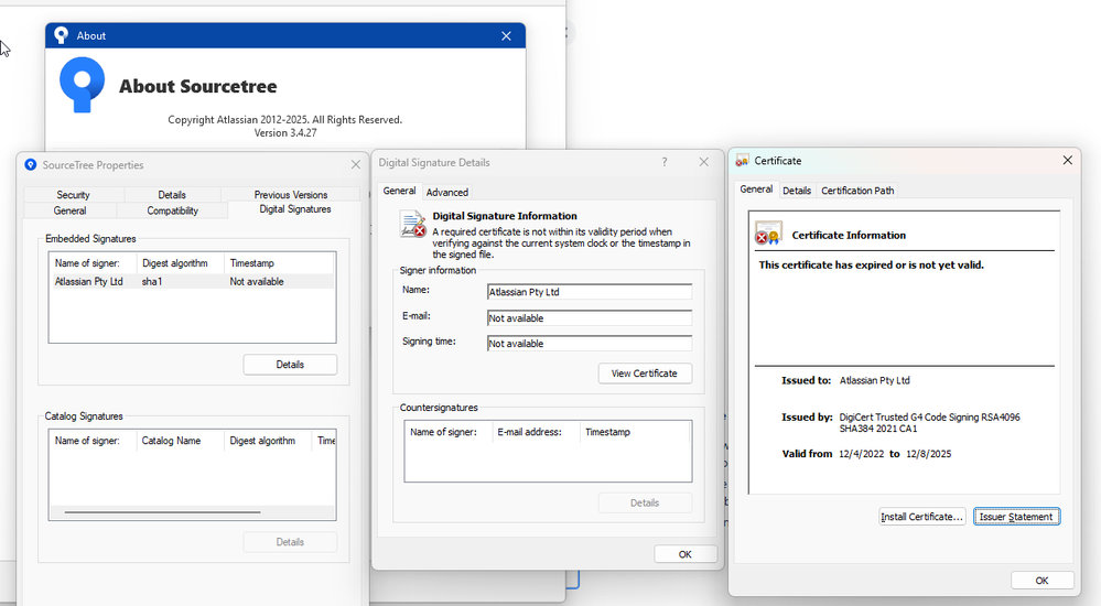

The SourceTree.exe certificate has expired for Windows. My company's security application is blocking the application from functioning correctly. This happened a few years ago.
Error:
'git log' failed with code -1"
System.ComponentModel.Win32Exception: Access is denied

Hmm, interesting @Dev
I've just downloaded 3.4.27 and I can see the same thing (difference is just in the timezone and the dates for the certificate) 🕑
Anyway, I can reach out to Community support to see if they can escalate this, but if not, you can create a bug report here: https://jira.atlassian.com/issues/?filter=98713
