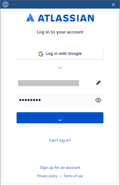

I'm experincing the same issue. I have tried the most recent version and a few others with the same result. I have also tried installing with admin rights. I get as far as here and it just keeps spinning.
I have noticed with Fiddler that it makes a call to POST https://id.atlassian.com/rest/saml/sso?application=sourcetree&continue=https%3A%2F%2Fid.atlassian.com%2Fprofile%2Fprofile.action with crsfToken and usersname in the body
Then there are 3 requests to OPTIONS https://auth.atlassian.com/usernamepassword/login each return with just the word "OK" in the body
Then nothing else happens.
