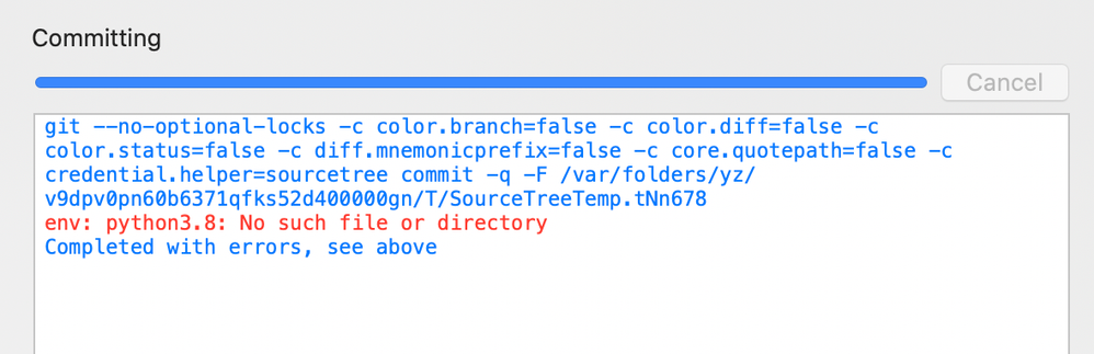

Deleted user
September 24, 2020
@Graham Borland1  @stevestreeting Can you elaborate this answer please as I am not getting any environment.plist file.
I am using Mac OS Catalina 10.15.4 and I am having problems with source tree as I am getting the same error as you.
Deleted user
September 24, 2020

Pablo Diaz-Gutierrez
September 24, 2020
Ok, I took another look and the new workaround is to edit the pre-commit hook file. So if you open `.git/hooks/pre-commit` or `.git/modules/SUBMODULENAME/hooks/pre-commit` in your repository, you see that it uses python3.8 in the first line. However, python3.8 lives on /usr/local/bin (the path that SourceTree ignores), whereas in /usr/bin (the path that SourceTree uses), I have python3.
Therefore, possible fixes:
- Replace python3.8 with python3 in the hook file (I did this), or
- Add the full path to python3.8, as in /usr/local/bin/python3.8
Like Deleted user likes this
Deleted user
September 24, 2020
@Pablo Diaz-Gutierrez  Both the fixes are working fine.
Awesome Pablo, Thanks a lot...
I wonder how you can able to debug this and find out the fix, it would be a lot helpful if you can explain that, it would really enhance my debugging skills. ☺️
