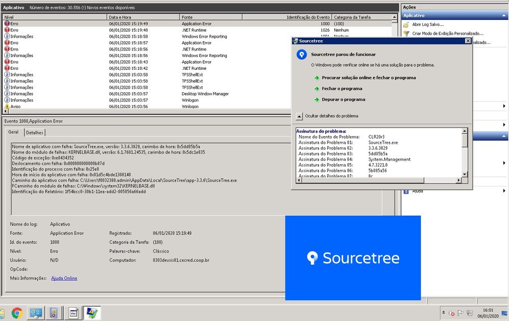

I'm facing a issue here while trying to update the sourcetree app to the latest version, during the update the setup just stop and frozen, when I try to reinstall  get the error on the picture below.
I already tried to remove the program folder, remove the registry entries, but the problem persist,, my SO is a WS2008 R2 x64.
The first question, is the SO 2008 R2 x64 compatbile with the sourcetree app?
The second question, anyone already faced a problem like this, and have some tips to me?

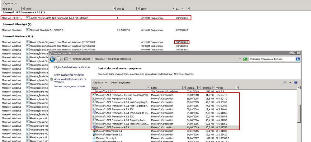

I checked this, but this specific KB was not installed in this server.
The last time that this server was updated was in 18/11/19. In image shows the version of the net framework installed 4.7.1.
