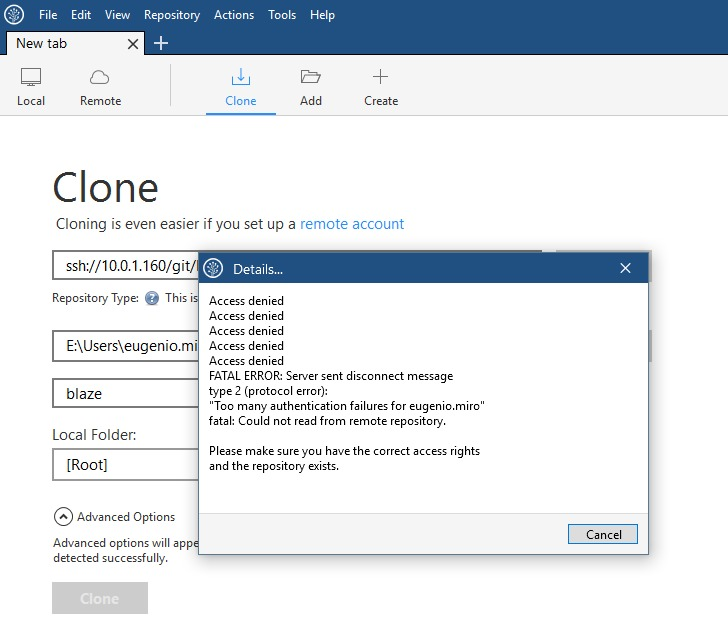

I tried your suggestion and unfortunately, it didn't work as expected, this is the output I get in the Details window, which is the same I get when using the already cloned repository.
Moreover, if this worked after removing and cloning the repo again, that wouldn't be the best solution either because I have several local branches I'd like to keep and also several stashes that are useful as they are, I'd prefer a solution keeping the current repository and changing the credentials. I started to check other options like GitKracken if this doesn't work, even if I don't like it so much, but this can be a deal breaker for me... and my team...
